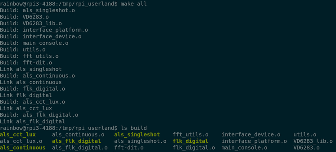

 I have downloaded the STSW-IMG302_LNX which has this description "Linux driver for VD6283 6-channel ambient light sensor, with flicker extraction expansion application programming interface (API)", I want to compile this driver for my embedded linux for arm64 platform, I don't know how can I compile it as there are number of files and folders as shown below.
The read me doesn't help me either. Do I need to make a module out of it and load that in my embedded linux ? if so then how ? I tried following,
I used aarch64-linux-gcc compiler. What I did was I executed make all which produced the build folder with a number of .o files, then I created an .a archive file out of it using command ar r mylib.a build/*.o and now I am not sure if I am suppose to make a main.c file and use this library when compiling my main.c file. I didn't find any good documentation and README file for the procedure. Following is where my sensor is connected on my embedded linux.

I’d like to clarify some points about the STSW-IMG302_LNX package and explain how to compile and use it.
1. Overview of the Package
The package provides a userland driver (runs in user space), meaning it is not a kernel module. It includes an adaptation layer to integrate the driver with specific platforms.
2. Compilation
a) make Command Without a Target
When you run make without specifying a target, a brief help message is displayed. For example:
b) make all Command
When you run make all, all the examples provided in the package are compiled. The resulting binaries are placed in the build directory. For example:
The application are in green.

4. Steps to Use the Driver
  1. Compile the Examples
    Run make all to compile the examples. The binaries will be available in the build directory.
  2. Adapt the Platform Layer
    If you are not using a Raspberry Pi, modify the files in the rpi_platform directory to adapt the communication to your hardware.
  3. Test the Examples
    Deploy the compiled binaries to your embedded Linux platform and test them to verify the sensor functionality.
  4. Create Your Own Application
    Use the examples in the example directory as a reference to write your own application. You can link your application with the libraries provided in the package.
