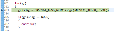

Hi I have connected the GNSS1A1 board and F446ZE boards. When I run the FW (Virtual Com Port) that I set up through STM32CUBE IDE (X-CUBE-GNSS) and start the program, when it enters MX_GNSS_Process() the gnssMsg struct's buffer pointer is pointing at reserved 0x2002 0000 address.

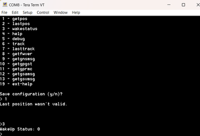

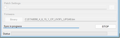

Then I tried generating the code for FW Updater example program, the Teseo Suit Can not do anything. It stops at Syncing, or if I try to force the update, at around 80% it freezes and recommends recovery mode. That doesn't work either.
 Please help. I tried everything I2C or UART port but it looks like nothing is helping. The GetPos example is running fine, however gets no data. 

Also when you debug code does it hit this function? You can set a breakpoint/BP inside one of the lines in fsm_sync and see if the program control hits that BP.
static void teseo_rx_callback_ok(void)

Secondly, on GetPos example, it looks like you are able to run that. Can you try options 10 and 11? Make sure you are testing outside or at a very minimum by a window to get some satellites. Please note for actual testing of GNSS you need an outside view but for firmware development or just checking out features of Teseo LIV3F, you can sit by a window (partial view of sky).
Please make sure you regenerate the projects in both cases i.e. whether running GetPos for Virtual_COM_PORT.
Virtual_COM_Port, outputs NMEA data into serial termianl.
GetPos - parses the data and stores in data structures.

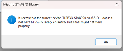

Thank you for the quick answer! I did reupload the correct firmware: STA8090_4_6_8_2_UPG26. However, now I get the error in Teseo Suite:
 GetGNSS message is still returning NULL however. After a power reset no such error showed up again.
I do not have the specific STM32 to try out. I have the NUCLEO-F401RE with me.  Also, I am surprised to see such an error coming out of Teseo Suite, therefore can we take this step-by-step?

When you programmed LIV3F with the firmware version shown above, did you use Teseo Suite or the firmware upgrader tool?

I used the TESEO suite for updating the fw.

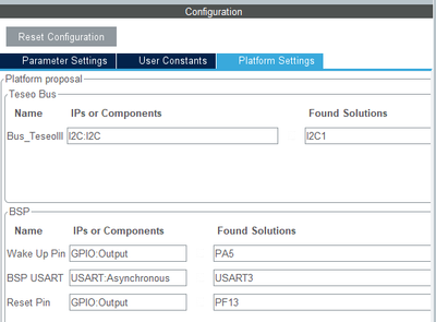

For me it is setup a bit differently. Im using the USART 6 as Asynchronous with 115200 baud rate of the NUCLEO-F446ZE. (Pins PG9, PG14 - > D0,D1). Jumpers on the GNSS1A1:

as for the message, this function returns a NULL value.

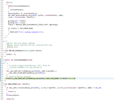

As for the VirtualComPort application is the loop where the app is stuck.
With the jumpers set up the way mentioned by you, Communication via I2C.
PPS blinking. PF13 set up as Reset Pin (GPIO status output HIGH)
Is USART6 between, STM32 and Teseo Module? If so, the module is configured by default at 9600, therefore setting the baud-rate to 115200 would be a problem.
