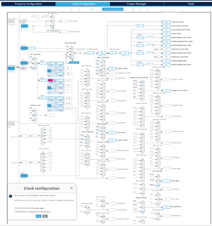

‎2024-08-07 12:36 AM
X-CUBE-AI changes the clock tree in order to provide you best performance by maximizing the MCU clock speed. However, changes are loaded after you receive this prompt:
If you don't want X-CUBE-AI to apply these clock settings, please click on "No" when receiving this pop-up.
If you still see changes in your clock tree after that, it is probably a bug and we will track it.

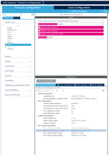

The changes I'm talking about occur straight away in the IOC as I'm working on it, before even going into the code.
This is the RCC definition in the IOC before adding the AI feature:
And the clock tree:

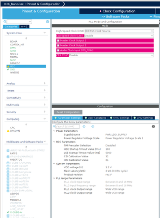

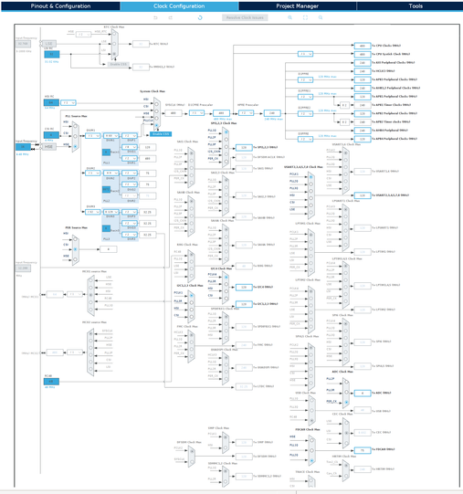

And these are the clock tree and RCC definitions after adding the AI feature:
These changes happen automatically as soon as I press the X-CUBE-AI feature in the middelware section of the IOC.
