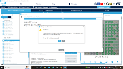

I have a problem with the validation on target of a CNN network on XcubeAI.
I tried to validate the networks on desktop, and it runs, but, when I try to validate on target it gives me that error, I ask you if someone has a solution or something else to try to fix this problem.
I'm using version 1.15.1 of STMCUBEIDE and v. 9.0.0 of cube AI
the board I try to validate is UFBGA144.

2024-07-25 10:12 AM
Good evening,
I tried to validate the project also with STM32CubeMX (last version) but I found the same error during the validation on target (as in photo).
I share also the link to take views of the network:
https://drive.google.com/file/d/1nyhqqx__dSITxwM6UkXgGykBv-6hhqGK/view?usp=sharing
Thank you for your availability, waiting your response, greetings.
2024-07-26 1:45 AM - edited 2024-07-26 1:47 AM
Your model requires 1.97MB of Flash and on this device there is 2MB available.
We consider that we need at least 30K for the program so you are probably just over the limit.
You have this message because during the analysis we report an error that the model won't fit on the target
Your model is a float model, using quantization you'll be able to make it fit on the target
By the way, on the developer cloud you can run your model on boards with more flash internally or externally
Regards
