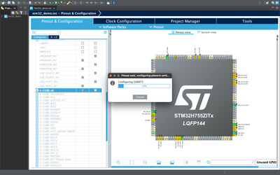

I have been trying to deploy a simple ML model on my STM32 NUCLEO H755ZIQ, i've been following a tutorial as am learning right now, but no matter how many times i try i cant seem to shake of these three errors:
1. when i try to open the XcubeAI  interface a dialogue pops up saying setting up USART3 but it never stops loading, i suppose its a bug but i leave it to the experts to decide what it is.

Screenshot 2025-08-21 at 3.18.22 PM.pngScreenshot 2025-08-21 at 3.46.29 PM.png
Hello @vigneshn10
Regarding the first point, the pop up of "Configuring USART3" is expected as the USART3 is used in Human Machine Interface(VCOM),
To avoid this, you should disable the HMI under Bsp or enable another USART peripheral.
