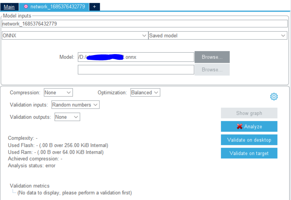

I have followed the tutorial https://www.youtube.com/watch?v=grgNXdkmzzQ&t=4s to test X-CUBE-AI with CubeMX5.0.1, but the step 'Analysis' just end with an error message without any details. I have received the same error with CubeIDE which comes with integrated CubeMX.
If I try to run 'Analysis' of the same model after selecting the board I receive the error as shown below. Could anyone please help me in figuring out where could be the problem? Do I require to install Python to run X-Cube-AI? That is not mentioned in the users manual or tutorial.

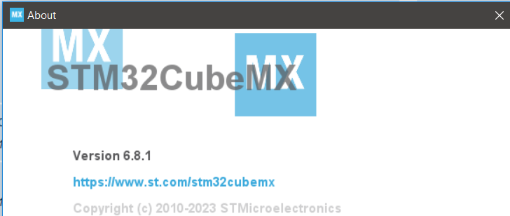

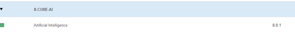

Can you reproduce the problem with a recent verstion of STM32CubeMX and X-CUBE-AI ?

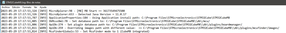

You may want to also look at STM32CubeMX log located under ~/.stm32cubemx/STM32CubeMX.log it should give more details.

I have the most recent sw.
An I can generate in cmd windows console but it is not possible run with Cubemx.
And Empty error appears. Any information appears in that log file.

can you see if you have the same behavior when you actually add the X-CUBE-AI extension in an MX project, not only the MCU finder.
tcg
That is the point, I want to know which MCU of your roadmap has enough flash/ram to run the NN.
For sure selected is not enougth.
We can talk in private and then add here the conclusion. Kind regards, T

From what I can see your model doesn't go through the stm32ai command line, you probably have more info either in the STM32CubeMX log or doing Windows->Output in MX.
