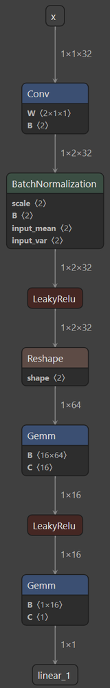

Dear Community,
I'm evaluating whether some of the STM32 ICs are suitable for future projects using simple CNNs (Convolutional Neural Networks).
I'm running into problems when trying to analyze a simple CNN model in the ONNX format (converted to ONNX from pyTorch) in the STM32CubeMX AI IDE. I'm using ST Edge AI Core v2.0.0-20049 and once I click on 'analyze' in the network tab, the IDE gives me the error 'INTERNAL ERROR: 'kernel_shape''.
Please see the model attached below.
I could not find any hint in the docs and as far as I know all the operations should be supported, shouldn't they?
I tried to experimenting with the layers and the kernel sizes but the error was not fixed.
The CONV-Layer is leading to the error.
I would be happy about a hint how to fix this error or if the platform does not support some operations or if there are some general issues known with CNNs.
I attached the ONNX model below.
Thank you!
Hello @STHenry@SlothGrill,
Yes indeed, it seems that it is the way you export the model that cause the issue:
You're using:
onnx_program = torch.onnx.export(torch_model, dummy_input, dynamo=True)
onnx_program.optimize()
onnx_program.save(path_onnx)
Problems:
dynamo=True:
  • This uses PyTorch’s newer Dynamo/FX2ONNX path, which outputs an intermediate IR, not a standard .onnx file directly.
  • That format is not compatible with STM32Cube.AI / ST Edge AI Core, which expects a classic .onnx file following ONNX opset specs
Find more information at the beginning of this documentation: https://stedgeai-dc.st.com/assets/embedded-docs/supported_ops_onnx.html)
I am not sure what exactly needs to be set, but something like this works:

Julian E.
Hello @STHenry,
In the documentation about onnx layer, it is written:
Conv
Performs convolution operation
  • category: convolutional layer
  • input data types: float32
  • output data types: float32
Specific constraints/recommendations:
  • arbitrary strides, provided that they are smaller than the input size
  • arbitrary filter kernel sizes, provided that they are smaller than the input size
In your case the error is kernel_shape, your input size is (1,1,32) and your kernel size is (2,1,1), it may be the cause of your issue.
FYI, the version 2.1 of the stedgeai is out and I would advise to always use the latest version as it includes all the fixes of previous version bugs. In this case, it still gives the issue.
Have a good day,
Julian
