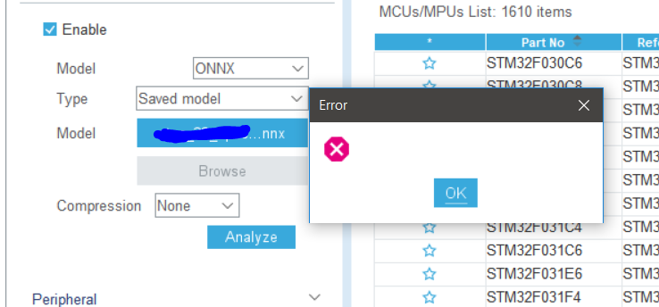

    tcg
    May 29, 2023
    Hi, i have the same problem.
    I can generate an analysis base on comand windows in cmd console.
     macc=6,532,325 weights=626,620 act=259,200 ram_io=3,300
    Creating txt report file C:\WINDOWS\system32\stm32ai_output\network_analyze_report.txt
    elapsed time (analyze): 113.465s
    But it is not posible to obtain by cube mx
    _legacyfs_online_stmicro_images_0693W00000bl3o6QAA.png Any idea about how obtain at least the log failed test.
    Thanks a lot for your time, T
    fauvarque.daniel
    May 29, 2023
    Can you reproduce the problem with a recent verstion of STM32CubeMX and X-CUBE-AI ?
    You may want to also look at STM32CubeMX log located under ~/.stm32cubemx/STM32CubeMX.log it should give more details.
    Regards
    ​In order to give better visibility on the answered topics, please click on 'Accept as Solution' on the reply which solved your issue or answered your question.
    tcg
    May 29, 2023
    I have the most recent sw.
    An I can generate in cmd windows console but it is not possible run with Cubemx.
    And Empty error appears. Any information appears in that log file.
    Kind regards, T
