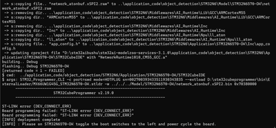

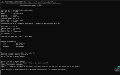

2025-05-21
2:46 AM
- last edited on
2025-06-30
12:04 AM
by
Maxime_MARCHETT
You can set the my_deployment_n6_ssd_mobilenet_v2_fpnlite_config.yaml Is the content of this file pasted out? I'll try.
*This post has been translated from Chinese to comply with the ST Community guidelines.
2025-05-21
2:47 AM
- last edited on
2025-06-30
12:01 AM
by
Maxime_MARCHETT
The problem has just been solved! Thank you! I'm currently getting a similar error to yours:

Okay, what error caused this? I'll take precautions too.

It should still be a problem with the config file my_deployment_n6_ssd_mobilenet_v2_fpnlite_config.yaml, I deleted all the paths and filled them in again, then ran it again and it ran successfully, thank you!

You could use another 5v-USB_SNK port for power and try again. As for how to use it, you reverse the development version, there are three jumpers next to each other, replace the first jumper cap on top of the second jumper, which is on top of the USB-SNK, and try again?

It still didn't work, I got this error after running the script file, then I tried the method I just mentioned, after a successful build with the N6 boot pin set to the right and powered by 5v-USB_SNK, the screen didn't respond when I connected it to the PC.

Maybe because I'm using a USB to Type-C cable (USB-A to USB-C)?
