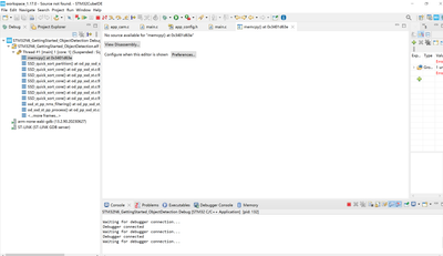

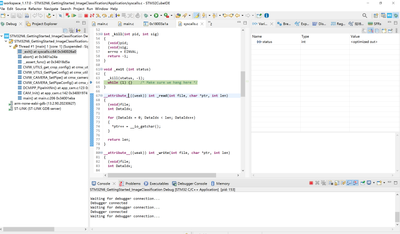

Hello, I use st-minst in ST Model Zoo to deploy my project, but when I burned stm32N6570_DK, it didn't work. However, I tried flower and food and they both worked fine. Why can't st-minst work? Are there other steps required?
This is my command and .yaml content
python stm32ai_main.py --config-path ./src/config_file_examples/ --config-name deployment_n6_config.yaml

I tried to modify the class_names content [0,1,2,3,4,5,6,7,8,9] but it still didn't work. I debugged in stm32CubeIDE and it stopped at the above picture. I don't know what's going on.
