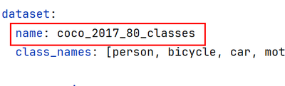

2025-05-15 8:42 PM
D:\stm32aibushu\stm32ai-modelzoo-services\object_detection\src>python stm32ai_main.py --config-path ./config_file_examples/ --config-name my_deployment_n6_ssd_mobilenet_v2_fpnlite_config.yaml
2025-05-16 11:30:17.018496: W tensorflow/stream_executor/platform/default/dso_loader.cc:64] Could not load dynamic library 'cudart64_110.dll'; dlerror: cudart64_110.dll not found
2025-05-16 11:30:17.018747: I tensorflow/stream_executor/cuda/cudart_stub.cc:29] Ignore above cudart dlerror if you do not have a GPU set up on your machine.
[WARNING] The usable GPU memory is unlimited.
Please consider setting the 'gpu_memory_limit' attribute in the 'general' section of your configuration file.
[INFO] : Running `deployment` operation mode
[INFO] : ClearML config check
[INFO] : The random seed for this simulation is 123
INFO: Created TensorFlow Lite XNNPACK delegate for CPU.
[INFO] : Generating C header file for Getting Started...
[INFO] : This TFLITE model doesnt contain a post-processing layer
loading model.. model_path="D:/stm32aibushu/stm32ai-modelzoo/object_detection/ssd_mobilenet_v2_fpnlite/ST_pretrainedmodel_public_dataset/coco_2017_person/ssd_mobilenet_v2_fpnlite_035_192/ssd_mobilenet_v2_fpnlite_035_192_int8.tflite"
loading conf file.. "../../application_code/object_detection/STM32N6/stmaic_STM32N6570-DK.conf" config="None"
"n6 release" configuration is used
[INFO] : Selected board : "STM32N6570-DK Getting Started Object Detection (STM32CubeIDE)" (stm32_cube_ide/n6 release/stm32n6)
[INFO] : Compiling the model and generating optimized C code + Lib/Inc files: D:/stm32aibushu/stm32ai-modelzoo/object_detection/ssd_mobilenet_v2_fpnlite/ST_pretrainedmodel_public_dataset/coco_2017_person/ssd_mobilenet_v2_fpnlite_035_192/ssd_mobilenet_v2_fpnlite_035_192_int8.tflite
setting STM.AI tools.. root_dir="", req_version=""
Cube AI Path: "D:\stm32edgeai\stedgeai\2.1\Utilities\windows\stedgeai.exe".
[INFO] : Offline CubeAI used; Selected tools: 10.1.0 (x-cube-ai pack)
compiling... "ssd_mobilenet_v2_fpnlite_035_192_int8_tflite" session
model_path : ['D:/stm32aibushu/stm32ai-modelzoo/object_detection/ssd_mobilenet_v2_fpnlite/ST_pretrainedmodel_public_dataset/coco_2017_person/ssd_mobilenet_v2_fpnlite_035_192/ssd_mobilenet_v2_fpnlite_035_192_int8.tflite']
tools : 10.1.0 (x-cube-ai pack)
target : "STM32N6570-DK Getting Started Object Detection (STM32CubeIDE)" (stm32_cube_ide/n6 release/stm32n6)
options : --st-neural-art default@../../application_code/object_detection/STM32N6/Model/user_neuralart.json --input-data-type uint8 --inputs-ch-position chlast
[returned code = 4294967295 - FAILED]
$ cwd: None
$ args: D:\stm32edgeai\stedgeai\2.1\Utilities\windows\stedgeai.exe generate --target stm32n6 -m D:/stm32aibushu/stm32ai-modelzoo/object_detection/ssd_mobilenet_v2_fpnlite/ST_pretrainedmodel_public_dataset/coco_2017_person/ssd_mobilenet_v2_fpnlite_035_192/ssd_mobilenet_v2_fpnlite_035_192_int8.tflite --output D:\stm32aibushu\stm32ai-modelzoo-services\object_detection\src\experiments_outputs\2025_05_16_11_30_18 --workspace D:\stm32aibushu\stm32ai-modelzoo-services\object_detection\src\experiments_outputs\2025_05_16_11_30_18 --st-neural-art default@../../application_code/object_detection/STM32N6/Model/user_neuralart.json --input-data-type uint8 --inputs-ch-position chlast
ST Edge AI Core v2.1.0-20194 329b0e98d

LOAD ERROR: WindowsPath('D:/stm32aibushu/stm32ai-modelzoo-services/object_detection/src/experiments_outputs/2025_05_16_11_30_18/network.h') and WindowsPath('D:/stm32aibushu/stm32ai-modelzoo-services/object_detection/src/experiments_outputs/2025_05_16_11_30_18/network.h') are the same file
$ cwd: None
Error executing job with overrides: []
Traceback (most recent call last):
File "D:\anaconda\lib\site-packages\clearml\binding\hydra_bind.py", line 230, in _patched_task_function
return task_function(a_config, *a_args, **a_kwargs)
File "D:\stm32aibushu\stm32ai-modelzoo-services\object_detection\src\stm32ai_main.py", line 228, in main
process_mode(cfg)
File "D:\stm32aibushu\stm32ai-modelzoo-services\object_detection\src\stm32ai_main.py", line 102, in process_mode
deploy(cfg)
File "D:\stm32aibushu\stm32ai-modelzoo-services\object_detection\src\../deployment\deploy.py", line 111, in deploy
stm32ai_deploy_stm32n6(target=board, stlink_serial_number=stlink_serial_number, stm32ai_version=stm32ai_version, c_project_path=c_project_path,
File "D:\stm32aibushu\stm32ai-modelzoo-services\object_detection\src\../../common/deployment\common_deploy.py", line 469, in stm32ai_deploy_stm32n6
stmaic_local_call(session)
File "D:\stm32aibushu\stm32ai-modelzoo-services\object_detection\src\../../common/deployment\common_deploy.py", line 443, in stmaic_local_call
stmaic.compile(session=session, options=opt, target=session._board_config)
File "D:\stm32aibushu\stm32ai-modelzoo-services\object_detection\src\../../common\stm32ai_local\compile.py", line 208, in cmd_compile
raise Exception('Error during compilation')
Exception: Error during compilation
Set the environment variable HYDRA_FULL_ERROR=1 for a complete stack trace.
2025-05-21
1:10 AM
- last edited on
2025-06-30
12:07 AM
by
Maxime_MARCHETT
Not yet, I use food classification and image classification.
*This post has been translated from Chinese to comply with the ST Community guidelines.
2025-05-21
1:14 AM
- last edited on
2025-06-30
12:08 AM
by
Maxime_MARCHETT
Ok ok, please for version 3.1.0 do you still follow that tutorial to configure the file and run the process, I see that there is no stm32ai_main.py file in the src folder of that tutorial but in the previous folder of src there is this .py file, thank you for your help!

Did you check your user_config.yaml file, is the name field missing?

general:
model_type: ssd_mobilenet_v2_fpnlite # 'st_ssd_mobilenet_v1', 'ssd_mobilenet_v2_fpnlite', 'tiny_yolo_v2', 'st_yolo_lc_v1', 'st_yolo_x', 'yolo_v8'
# path to a `.tflite` or `.onnx` file.
model_path: D:/stm32aibushu/stm32ai-modelzoo/object_detection/ssd_mobilenet_v2_fpnlite/ST_pretrainedmodel_public_dataset/coco_2017_80_classes/ssd_mobilenet_v2_fpnlite_100_256/ssd_mobilenet_v2_fpnlite_100_256_int8.tflite
operation_mode: deployment
dataset:
class_names: [person, bicycle, car, motorcycle, airplane, bus, train, truck, boat, traffic light, fire hydrant, stop sign, parking meter, bench, bird, cat, dog, horse, sheep, cow, elephant, bear, zebra, giraffe, backpack, umbrella, handbag, tie, suitcase, frisbee, skis, snowboard, sports ball, kite, baseball bat, baseball glove, skateboard, surfboard, tennis racket, bottle, wine glass, cup, fork, knife, spoon, bowl, banana, apple, sandwich, orange, broccoli, carrot, hot dog, pizza, donut, cake, chair, couch, potted plant, bed, dining table, toilet, tv, laptop, mouse, remote, keyboard, cell phone, microwave, oven, toaster, sink, refrigerator, book, clock, vase, scissors, teddy bear, hair drier, toothbrush]
preprocessing:
resizing:
interpolation: bilinear
aspect_ratio: crop
color_mode: rgb # rgb, bgr
postprocessing:
confidence_thresh: 0.6
NMS_thresh: 0.5
IoU_eval_thresh: 0.4
yolo_anchors: # Only applicable for YoloV2
max_detection_boxes: 10
tools:
stedgeai:
version: 10.1.0
optimization: balanced
on_cloud: False # Not Available For STM32N6
path_to_stedgeai: D:/stm32edgeai/stedgeai/2.1/Utilities/windows/stedgeai.exe
path_to_cubeIDE: D:/Stm32Cubbeide/STM32CubeIDE_1.16.0/STM32CubeIDE/stm32cubeide.exe
deployment:
c_project_path: ../application_code/object_detection/STM32N6/
IDE: GCC
verbosity: 1
hardware_setup:
serie: STM32N6
board: STM32N6570-DK
hydra:
run:
dir: ./src/experiments_outputs/${now:%Y_%m_%d_%H_%M_%S}
mlflow:
uri: ./src/experiments_outputs/mlruns
There's no shortage of it. It's mine. "D:\stm32aibushu\stm32ai-modelzoo-services-3.1.0\object_detection\src\config_file_examples\my_deployment_n6_ssd_mobilenet_v2_fpnlite_config.yaml" file.
