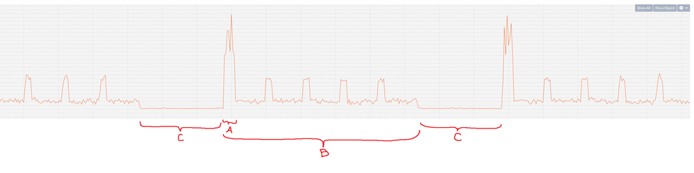

Thank you for the answer, while this clarifies it a bit I'm still slightly unsure how to interpret the results. To clarify what I mean, attached is the graph of a 5 layer model instead (still using the STedgeAI validation command with 10 samples). As you might see there are 10 clusters of 5 spikes, each spike being the activity per layer. Attached is also the report produced by the validation.
The report claims a average time per sample of 73,88ms yet when checking the graph the first spike alone seems to be around that size, as if it ignores the remaining layers (See A in the picture below). The average time per sample when including callbacks on the other hand states 1380,10ms which seems to match the time from the first spike in the 5 spike series until the end of the more noisy activity (see B below). Am I correct in assuming that B in this case is the "DEVICE duration" from the validation which only includes model related callbacks while C is the UART/USB communication, or does the "DEVICE duration" also include UART/USB communication and would therefore be a combination of B and C? If B is "DEVICE duration", would it then be more appropriate to count B as a single inference rather than A?

So, in your graph if you say A is the inference, then i would say that
  • C might be the phase where the inputs are sent to the board through UART (31360 Bytes sent)
  • A is the inference (73.xx ms) + layers inference time are sent through callbacks
  • In B-A,
    • the outputs are sent to from the board to the host (10 bytes - this should be quick)
    • then, i have to double check what is going on in the "noisy part" you are referring to (it could be a kind of cleanup but this seems a bit lengthy, or a kind of "wait state" but then maybe it should not be accounted for in the "device duration")
For the 1380,10ms, i have to double check, but this one should be the sum of sending input tensor(s)/doing the inference -and sending intermediate data through uart-/sending the output tensor(s)
Anyway if you want a bit more detail, you can call the checker.py with --debug option, you will see an output with the UART messages (and a bit of description of what is going on).

What is strange in your data is that you say you have made a model with "only 5 layers" (and shared the stpm of it + the validation report). In fact, in the validation report there is around 700 operators implemented in software, which is not even close to "5 layers".
Could you please state what are your "5 layers" (it looks like they are not "standard layers" and as such the tool is not generating "only 5 nodes" in C :) )? Would you mind sharing the file you use as input for stedgeai ?
From what we can understand by comparing the report and the stpm,
  • Lots of time is spent during inference to send data through UART (700 nodes means 700 times sending information about the node that just finished executing) --> This explains why the "duration with callbacks" is so long
  • Compared to that, the time spent doing the inference is very low (most of nodes have a small execution time) -> this explain why "duration w/o callbacks" is so short.
Most likely, in "B" of your graph, there is the inference+UART transfers all around, but it is nearly impossible to untangle pure CPU inference time from UART transfer time because the sampling rate of the measures is way too small (i.e. you try to observe events that last 1ms by sampling one point each 10ms).
As proposed above, could you try doing the same experiment and try to make the sampling rate higher (i.e. high enough to observe the events duration you expect).
For the last point, when using Neural-Art, it is possible that the model is better supported by the tool for NPU than for the CPU. It may then end up with way less epochs than the number of nodes you have here. Thus, less time is spent sending data through UART -> durations w/ and w/o callbacks might be closer because of this.

With the higher temporal resolution, the graph is easier to understand (tell me if this is not the case for you)
for the MCU graph:
  • The validation report shows there are 10x "Dense" layers that take 16+ms each, preceded by a Slice that take 1ms each
  • The stpm graph clearly shows the 10x 16+ms pattern with higher consumption levels ... let's say this is the rough mean level when the CPU is doing some "intense" computations.
  • Based on what has been discussed already... the stpm then shows lots of "peaks" (my guess is there are as many "diracs" as the number of layers shown in the report... i did not count :)) around this value after the 10x16ms batch, which i would say it's "inference computations" so to speak. Separated by less intense consumption (on the core, but might be different on IOs ) which are likely to be time spent sending data to the host machine.
  • -> with the higher sampling rate, you can easily understand the difference between:
    • "pure inference time" is the sum of the length of the peaks,
    • duration with callbacks takes the UART time into account (which takes most of the time here)
