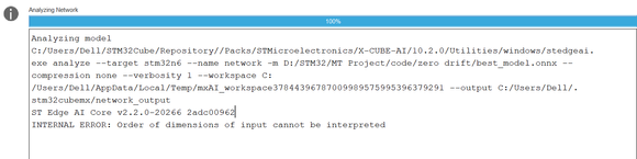

Hello, I'm trying to generate C code for my Onnx model using ST Edge AI Core.
I've tried both X-CUBE-AI and ST Edge AI Developer Cloud, and they gave me the same error:

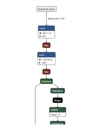

It's strange that Netron could still draw the correct graph containing the dimensions of input .Does this indicate that the input dimension has been successfully parsed?
I tried simplifying the model input, but it still reported an error. Can anyone give me some advice? Thank you.

Hello @Levy-hy,
Your onnx model seem fine as you pointed out.
The error here says that the st edge ai core (the CLI behind both X Cube AI and Dev cloud) is having an issue while converting it. It is the C conversion that has an issue, not your model.
It could come from unsupported layer, bug, other issue.
Could you share your model?
You can try to use the --use-onnx-simplifier in X Cube MX or Dev cloud.
In X Cube AI, above the Analyze button, you should see a wheel (parameters) button. In here, you can add a command (bottom of the first page menu).
Have a good day,
Julian

Hi @Julian E.
Thank you for explaining the error for me!
I tried adding --use-onnx-simplifier in extra command line, but then I got an error message about the transpose of the LSTM model.
Perhaps there are some layers in my model that Edge AI cannot recognize? I will try to modify the model and see if it could work.

Hello @Levy-hy,
Yes, your error in this case seems to be due to a parameter of Transpose not being supported.
You can find the list of supported layers here:
https://stedgeai-dc.st.com/assets/embedded-docs/index.html
In the section: Supported layers/operators
If you are using the N6 and the NPU, you have to look at the page: ST Neural-ART NPU - Supported operators and limitations.
To upload your model, you have to zip it.
Please first try to edit your model. If the issue is just that a layer is not supported, I can just report it to the dev team, nothing more.
