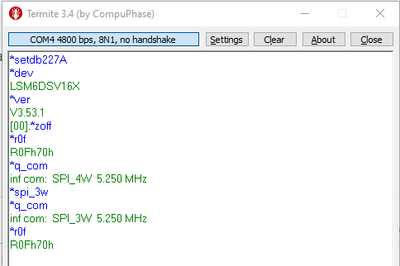

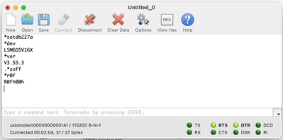

Trying to get to the bottom of this I have been issuing commands using a serial terminal.
The who_am_i register is not being read correctly. If you then hotplug the MEMS board, so it is no-longer in 3-wire SPI, it returns the correct 0x70 on regular SPI as shown on my logic analyzer image in a previous post above, but the GUI returns 00h still because it is anticipating 3-wire SPI.
If you could confirm the GUI works with the latest unico + binary, plus try these serial commands, it could help me figure out if there's a hardware issue.

Federica Bossi
Hi @JeffWelder ,
I confirm you that the device should work:
Can you check with q_com in which configuration you are?
Thank you for testing this! :)
Attached are my results.
If you can provide v3.53.1 I would be willing to try it, otherwise I think I have to return the board(s) as defective?

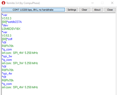

Hi @JeffWelder ,
I also tried with version 3.53.3, so that cannot be the issue, I'm sorry =\
anyway, I would like to check one last thing:
the SPI 4Wire read is the one at fault, and the SPI 3Wire is good, right? (from the previous messages, I understood the opposite =P)

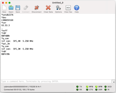

JeffWelder
@niccolò @Federica Bossi
Yes, I seemed to have been mistaken between my logic analyzer lines, 3W works, and 4W does not.
So, I bought another brand new dev-kit and eval board from Mouser instead of Digi-Key, and I have the same exact symptoms.
3W works, and 4W does not through our Terminal test.

Hi @JeffWelder ,
could you check all the lines SDO,SDA,CLK,CS during a 4W SPI read of the WHO_AM_I register?
so that we can confirm that the communication is coming back on the right line.
