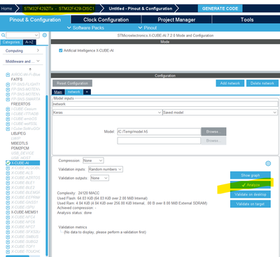

Hello
I Just tried the model with your board, and I get a correct analyse
