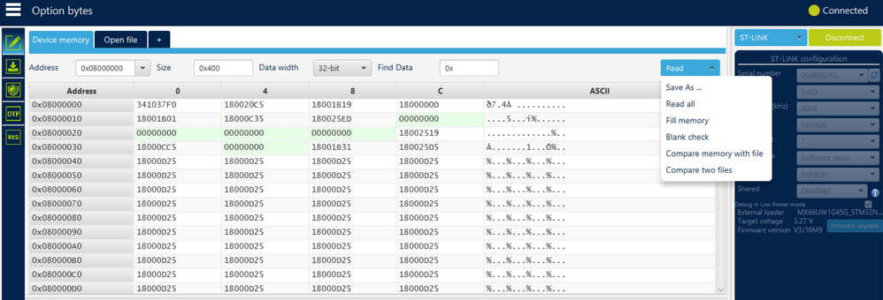

I see. Could you specify the error messages you see when trying to run the application? Also, during your latest successful debugging session, did you program any option bytes? To resolve this, try connecting to your board using STM32CubeProgrammer, select the OB tab from the left bar, click the arrow next to Read, and choose Reset MCU to factory settings.
To improve visibility of answered topics, please click 'Accept as Solution' on the reply that resolved your issue or answered your question.

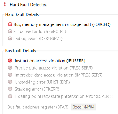

So when I debug it and let it run, I jump to the HardFault_Handler(). The Fault Analyzer looks like this:
Unfortunately under the OB tab I can not find the option Reset MCU to factory settings. It looks like this:
And as far as I know, I didn't program any option bytes, at least I didn't do it on purpose.

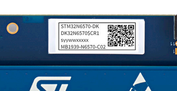

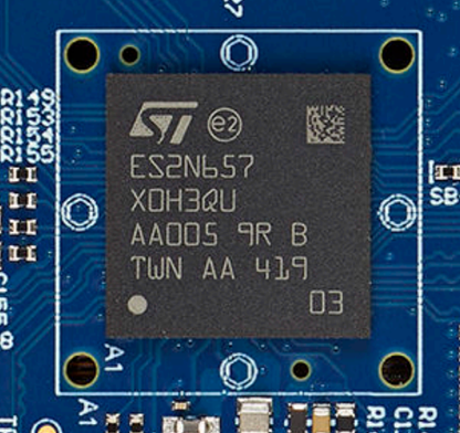

Hello @Pfaa
There are no Option bytes on the STM32N6, only OTPs (One-Time Programmable bits). And I have checked the list of OTPs you sent, and it seems correct to me.
I understand your issue is that on a single board, you cannot debug a project in DEV_BOOT (BOOT1=1) nor execute it in FlashBoot (from flash memory).
Can you confirm the following points:
  1. In DEV_BOOT, after a reset, is LED2 (red) is on?
  2. Has this failing board worked in the past? What is its origin?
  3. Can you share both the version of your STM32N657-DK and the marking of the non-working STM32N6?
Please find below the images you need to check:
Best regards
