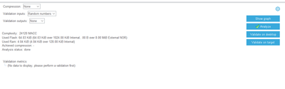

this is strange,
I just checked on my side:
with model freshly downloaded from link given by wiki, and installed 7.2 version of X-CUBE_AI
as you can see analyze is passing .
I am using cube-mx 6.12
