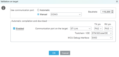

But Validate on target gives me a compilation error.

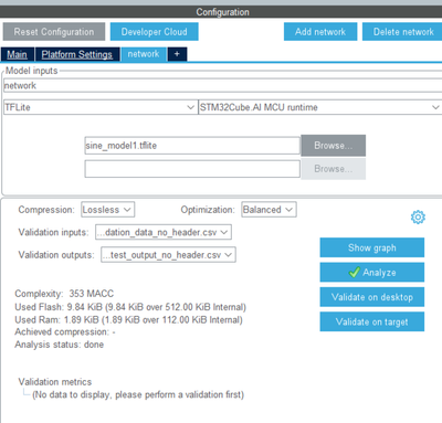

Validation process expects your board to be in "Waiting (State 1)" state but it seems that it failed to "Error (State 4)" state.
Interestingly, with the .elf file in your project, it hangs on my board (NUCLEO-G474RE). However, while re-generating and compiling your project (with this tweak) on my side, it performs correctly on the target.
Could you please give it a shot by:
- Opening your project in STM32CubeMX
- Go to "X-CUBE-AI"
- select your network ("network" tab)
- Go to Advanced Settings
- Go to "Memory Pools" tab
- Remove "POOL_0_RAM" by clicking "delete" and click on "insert". You should have a new pool named "pool1".
After that, you can either retry a "Validation on target" or generate your project and flash it with STM32CubeProgrammer.

Since you answered with STM32CubeIDE version, are you using STM32CubeMX embedded in STM32CubeIDE ? If yes, could you please install STM32CubeMX directly and try the same action with the standalone tool ? You can open the IOC file directly in STM32CubeMX.
STM32CubeMX - STM32Cube initialization code generator - STMicroelectronics
As @Tesla DeLorean said, it might be a include path or missing files. However, since it is from the automatic validation on target action, user does not have any action to do to include these files. We were aware of issues when code generation was performed with STM32CubeMX inside STM32CubeIDE, that's why my proposal is to perform it with the standalone tool.
As a second action, you could switch your application from "SystemPerformance" to "Validation", generate a project, compile/flash and do "Validation on target" without automatic compilation.
- Go to "X-CUBE-AI"
Best regards,
Yanis
Yes thanks it worked here too!
