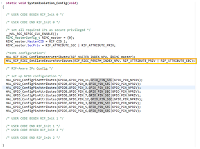

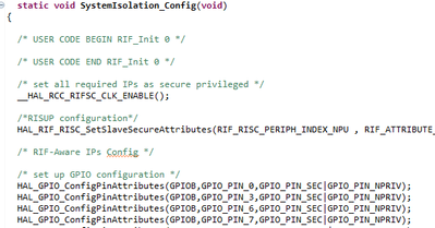

However, CubeMX did not initialize the required code lines noted in the guide under "Important note 2".
Guide's screenshot:
My screenshot:
I did small address adaptions for the NUCLEO-N657X0-Q

I will attach the project below. Did I make a mistake or is CubeMX not able to configure the NUCLEO-N657X0-Q in the same way it supports the STM32N6570-DK yet? I also tried adding the lines from the screenshot of the guide myself, but it didn’t change the results and I assume there is more missing than is visible in the guide's screenshot.  I also assume the missing RIF and RIMC code lines are the main reason why the application didn’t work.
I still wrote all necessary files to flash, but the result is that I don’t get any messages from the serial port. Only the FSBL LED turns on and off again. The LED toggled in the Appli remains turned off.

Hello @sop,
I am doing the same thing to write an article on the Nucleo.
I am struggling with strange behaviors that I think come from CubeMX.
As you pointed out, sometimes it does not initialize the code for the RIF correctly, or the RAM.
I managed to create a project that works on the Nucleo, but I want to test it further before giving out the steps as I struggles to succeed 100% of the time. (I may do mistakes sometimes, but I feel like I have more issues when I use the standalone CubeMX than the one inside CubeIDE)
If I succeed replicating it, I should write the article quickly, as it is almost identical to the DK one.
