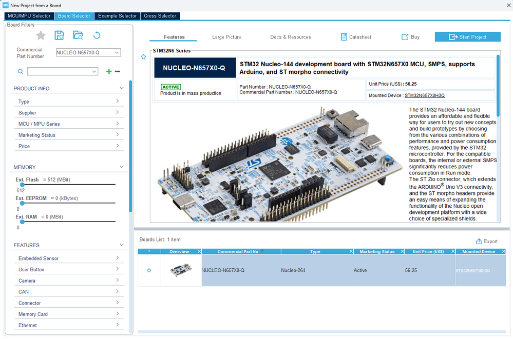

3.1 Create a project
You can create a project in either the standalone STM32CubeMX application or the integrated STM32CubeMX version within STM32CubeIDE. The standard approach is to design the project in STM32CubeMX and then export it to STM32CubeIDE. This method is used in this tutorial.

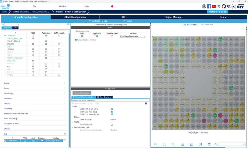

Begin your project by clicking Access to board selector and selecting NUCLEO-N657X0-Q, which corresponds to the STM32N6 Discovery kit board.
When asked to "Initialize all peripherals with their default Mode", click [No].
While some peripherals may be enabled by default, remove any that are unnecessary to avoid pin conflicts.
Select "Secure domain only" and click [OK]:

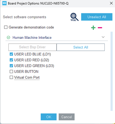

When prompted about board project options, you can select LD1, LD2, and LD3 as shown below:
We can proceed with the configuration.

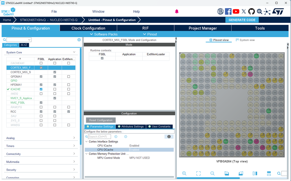

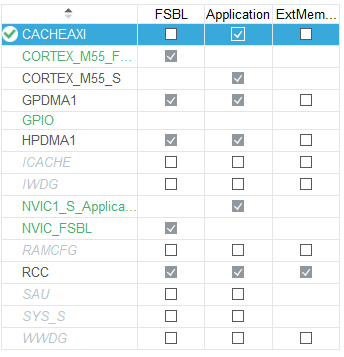

3.2.1 System core
Enable the CPU ICACHE and CPU DCACHE.
Enable CACHEAXI.
Ensure that ICACHE is disabled.
3.2.2 LEDs
To know if the code is running correctly, LED blue and LED red is used to flag the execution state of respectively the FSBL and the Application. The BSP package allows initializing and using these LEDs without the need to configure them directly. To do such, enable BSP for both FSBL and Application runtime contexts and select all LEDs, as shown in the following image:

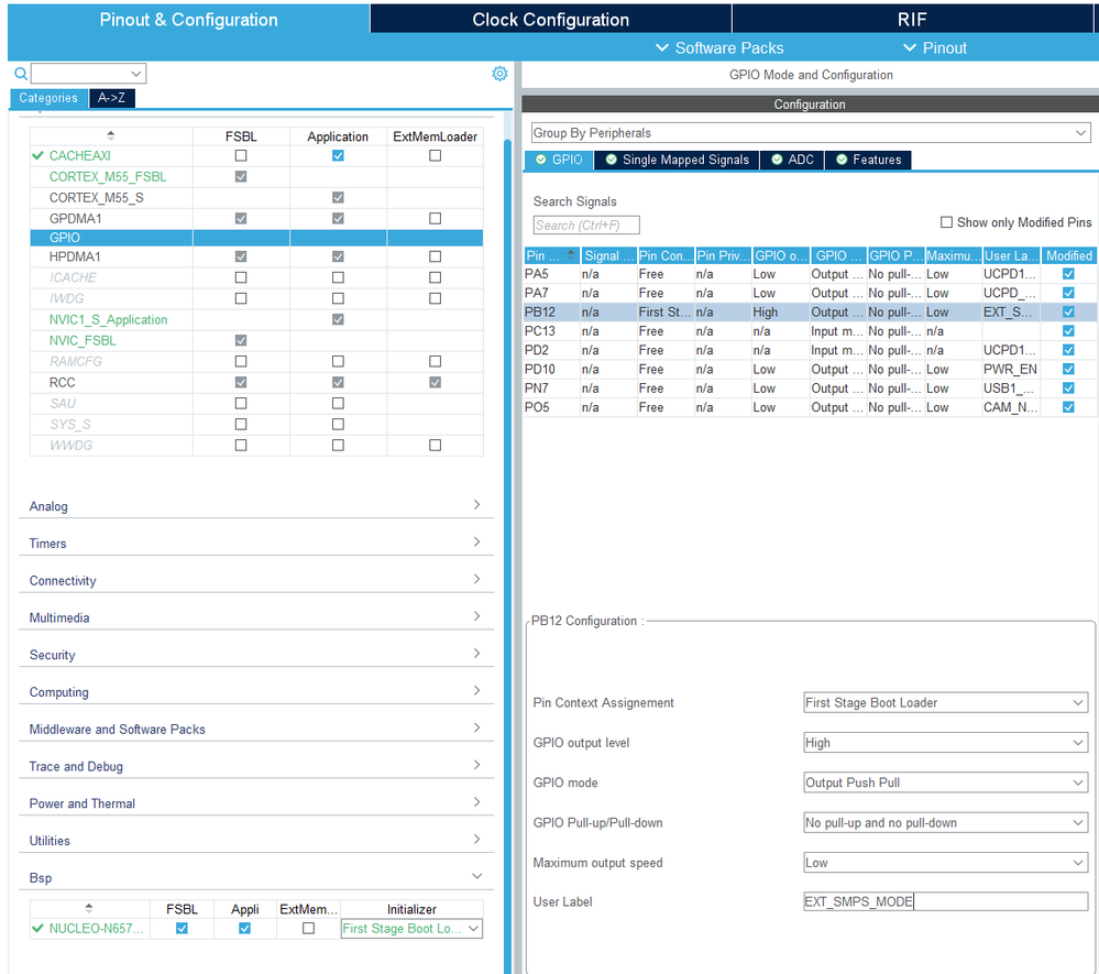

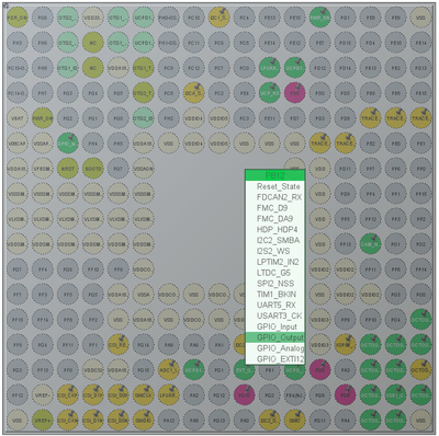

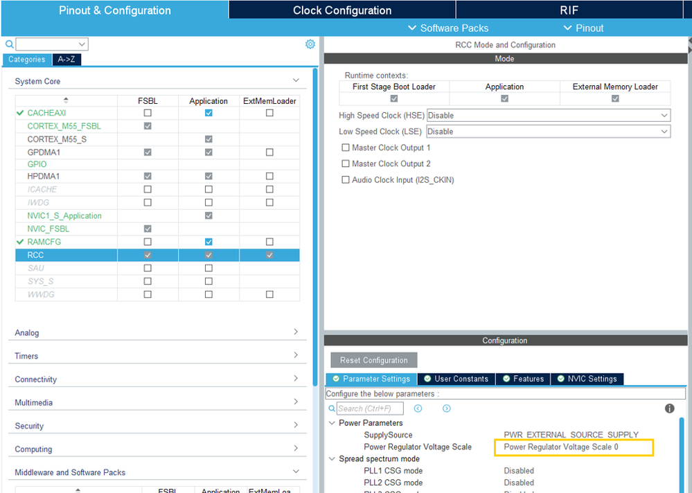

3.2.3 Overdrive mode
To enable overdrive mode, where the CPU operates at its maximum frequency (as shown below in the table from the STM32N6 datasheet), the EXT_SMPS_MODE pin must be configured. According to the NUCLEO-N657X0-Q user manual, this corresponds to pin PB12.
Therefore, pin PB12 has to be set as GPIO_Output:
And configured as follow in the GPIO menu:
Additionally, the maximum CPU frequency in overdrive mode requires setting the "Power Regulator Voltage Scale" to "0." Ensure that this configuration is applied in the RCC section.

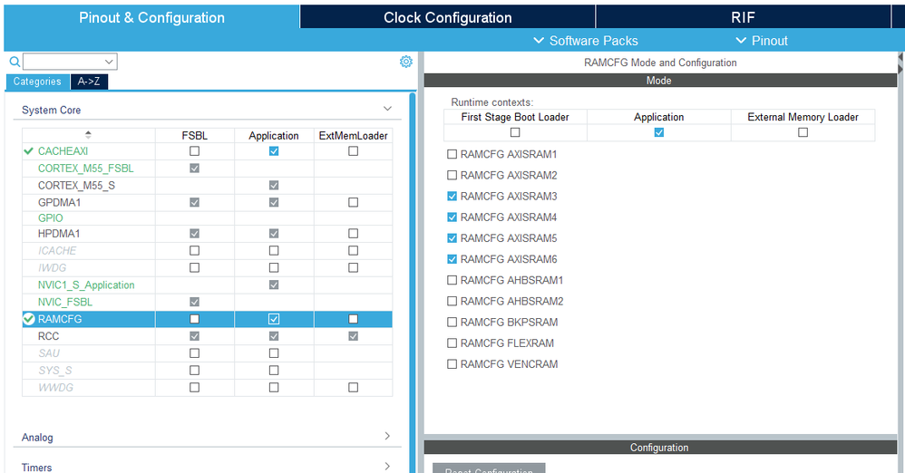

Since intermediate activations during inference are stored in RAM, enable the RAM controllers accordingly.

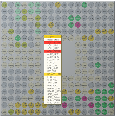

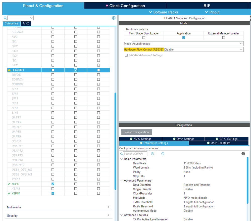

3.2.5.2 Configure serial communication for debugging
The serial interface LUSART1 (PE5/PE6), which supports the bootloader, is directly accessible as a Virtual COM port on the PC when connected via the STLINK-V3EC USB connector (CN6). We use this interface to redirect the ‘printf‘ output, enabling easy debugging through a serial terminal. Enable LUSART1 for the Application runtime context, set the mode to "Asynchronous", and configure the baud rate to 115200 bit/s
As you can see below, there is a conflict shown in orange. To fix it, change the pin PA11 to LUSART1_CTS:

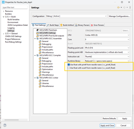

To redirect ‘printf‘, additional code needs to be added to your project. This is done later.

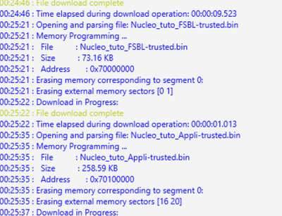

If you are unsure of the sizes, you can first generate the binaries using estimated values, then adjust the configuration accordingly and regenerate.
For this project, the FSBL binary is approximately 65 KB, and the Appli binary is around 295 KB. The board’s memory map is shown below.
Note two key addresses in this map: the secure RAM block starts at address ‘0x34000000‘, and the octo-SPI flash (interfaced by XSPI2) starts at address ‘0x70000000‘.
Upon power-up, the boot ROM is executed first. After that, the FSBL (stored at the beginning of flash) is copied into RAM and executed. The FSBL then copies the Appli binary from flash to RAM and executes it. Thus, the FSBL binary is stored at ‘0x70000000‘.
The Appli binary should be placed at an address offset greater than the FSBL size. Choosing an offset of ‘0x00100000‘ (1 MB) provides ample space. The code size corresponds to the Appli binary size; ‘0x0004BAF0‘ (310 KB) offers a suitable margin.

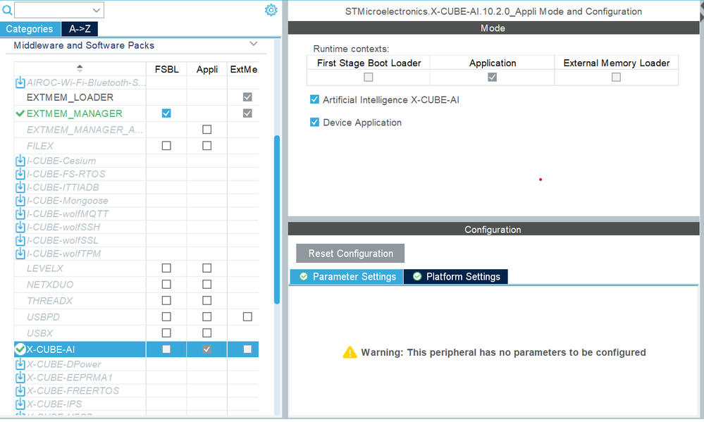

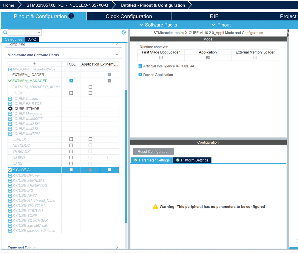

3.2.8.2 Configure the X-CUBE-AI middleware
The X-CUBE-AI middleware is used to generate application code for running neural network inferences. Enable it in the Application context and select "Application Template" as the application type.
When asked if you want to automatically fix peripherals and clocks, click [No].
In this tutorial, the object detection model from the ST model zoo is used (link). Get the quantized .tflite model.
For your information: You can find script to retrain, deploy example application and much more for different use cases (image classification, object detection, audio detection etc.) on our GitHub model zoo services:
GitHub: AI model zoo services for STM32 devices
Select "TFLite" and browse for your model. Additionally, select the profile "n6-allmems-03" if not already used by default.

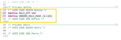

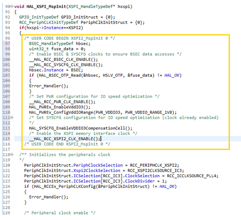

First of all, you should complement BSEC initialization. First, add the following constants into the private define area of stm32n6xx_hal_msp.c
#define HSLV_OTP 124
#define VDDIO3_HSLV_MASK (1<<15)
Then proceed to add the following piece of code into the HAL_XSPI_MspInit function.
BSEC_HandleTypeDef hbsec;
uint32_t fuse_data = 0;
/* Enable BSEC & SYSCFG clocks to ensure BSEC data accesses */
__HAL_RCC_BSEC_CLK_ENABLE();
__HAL_RCC_SYSCFG_CLK_ENABLE();
hbsec.Instance = BSEC;
if (HAL_BSEC_OTP_Read(&hbsec, HSLV_OTP, &fuse_data) != HAL_OK)
Error_Handler();
/* Set PWR configuration for IO speed optimization */
__HAL_RCC_PWR_CLK_ENABLE();
HAL_PWREx_EnableVddIO3();
HAL_PWREx_ConfigVddIORange(PWR_VDDIO3, PWR_VDDIO_RANGE_1V8);
/* Set SYSCFG configuration for IO speed optimization (clock already enabled)
HAL_SYSCFG_EnableVDDIO3CompensationCell();
/* Enable the XSPI memory interface clock */
__HAL_RCC_XSPI2_CLK_ENABLE();

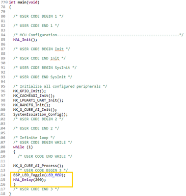

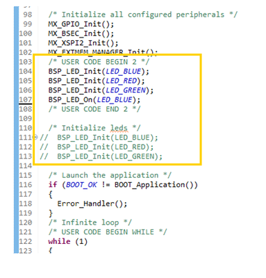

Now, you should add some code into the main functions of each project to use the LEDs to flag good execution. In the FSBL, to turn on the blue LED add functions call accordingly to the following image. Note that the initialization added by STM32CubeMX was commented out and this same piece of code was added under the User Area Code 2. This was done because the function to turn the LED blue on has to be called before booting the application. This is the only User Area Code available for such a purpose. Be aware that the section commented out may uncomment itself after STM32CubeMX modifications so be sure to comment it before rebuilding.
In FSBL main.c:
BSP_LED_Init(LED_BLUE);
BSP_LED_Init(LED_RED);
BSP_LED_Init(LED_GREEN);
BSP_LED_On(LED_BLUE);

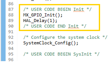

Moreover, the Overdrive mode selection pin must be high before configuring the clock. Make sure to add the GPIO init function before the system clock initialization, as shown in the image below.
MX_GPIO_Init();
HAL_Delay(1);

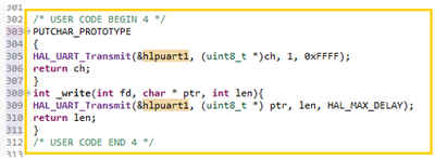

4.2 Add code in Appli
Next, go to the Appli project. At the top of ‘main.c‘, in the private define section, declare the following macro for the ‘put_char‘ function.
#define PUTCHAR_PROTOTYPE int __io_putchar(int ch)
Then, in the ‘User Code 4‘ section at the bottom of ‘main.c‘, implement the following functions:
PUTCHAR_PROTOTYPE
HAL_UART_Transmit(&hlpuart1, (uint8_t *)ch, 1, 0xFFFF);
return ch;
int _write(int fd, char * ptr, int len){
HAL_UART_Transmit(&hlpuart1, (uint8_t *) ptr, len, HAL_MAX_DELAY);
return len;
Within ‘main.c‘, in the X-CUBE-AI initialization function, add the following lines (if not already present) to enable the RAM sections that were previously initialized and enabled:
RAMCFG_SRAM2_AXI->CR &= ~RAMCFG_CR_SRAMSD;
RAMCFG_SRAM3_AXI->CR &= ~RAMCFG_CR_SRAMSD;
RAMCFG_SRAM4_AXI->CR &= ~RAMCFG_CR_SRAMSD;
RAMCFG_SRAM5_AXI->CR &= ~RAMCFG_CR_SRAMSD;
RAMCFG_SRAM6_AXI->CR &= ~RAMCFG_CR_SRAMSD;

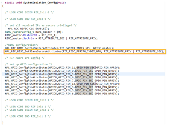

Important note: Depending on the version of CubeMX, X-CUBE-AI, and the STM32N6Cube package, you may have different things in this MX_X_CubeAI_Init() function. Edit it if needed to have exactly what is in the image above.

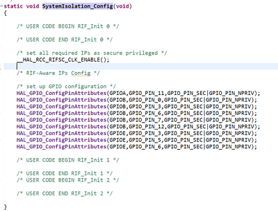

Add the following line to the RIF (SystemIsolation_Config) function to complete the slave configuration:
HAL_RIF_RISC_SetSlaveSecureAttributes(RIF_RISC_PERIPH_INDEX_NPU, RIF_ATTRIBUTE_PRIV | RIF_ATTRIBUTE_SEC);
Important note 2: Make sure that the part of the code above the line we add is present in the generated code. If not, it may indicate an issue in the RIF configuration. Make sure to look back at the Security configuration in CubeMX and that the NPU is selected in the RIF tab of CubeMX.

You most likely have to enable use float with printf as shown below:

To ensure that the application was correctly copied, that the peripheral initialization succeeded, and that the main loop is not stuck during inference, add the following two lines of code to blink the red LED:
 BSP_LED_Toggle(LED_RED);
 HAL_Delay(200);

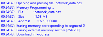

5.2 Generate model weights binary image
In your project folder, you can find at the root a file named network_data.xSPI2.raw that contains the weights of your model. This file results from X-CUBE-AI and in particular is the result of the ST Edge AI Core command running behind it:
stedgeai generate --model Model_File.tflite --target stm32n6 --st-neural-art
Documentation: https://stedgeai-dc.st.com/assets/embedded-docs/index.html
In our case, we want to rename and convert this file to network_data.xSPI2.bin:
cp network_atonbuf.xSPI2.raw network_data.xSPI2.bin
Next, add the path to ‘arm-none-eabi-objcopy‘ to your environment variables. You can find it in your STM32CubeIDE installation, typically under: C:/ST/STM32CubeIDE_<version>/STM32CubeIDE/plugins/ com.st.stm32cube. ide.mcu.externaltools.gnu-tools-for-stm32.13.3.rel1.win32_1.0.0.202411081344/ tools/bin. This tool allows you to convert the ‘.bin‘ file into a ‘.hex‘ file with a specified flash memory address:
arm-none-eabi-objcopy -I binary network_data.xSPI2.bin --change-addresses 0x71000000 -O ihex network_data.hex
 You now have the hexadecimal file containing fixed weights and parameters ready for flashing.
5.3 Flash binaries with STM32CubeProgrammer
We now have all three image files: the FSBL, the application, and the model weights.
Open STM32CubeProgrammer and ensure that your ST-LINK configuration matches the image below and confirm that the firmware is up to date.
Set your NUCLEO-N657X0-Q board to development boot mode (Boot1 and Boot2 to the right) and click [Connect] in STM32CubeProgrammer.
Boot switches on the Nucleo board:
On the image, the board boots from flash mode.
FSBL and application are binary files, and their flashing addresses must be specified manually.
  • Flash FSBL to the start of OctoFlash at ‘0x70000000‘.
  • Flash the application to ‘0x70100000‘, based on the offset defined in the external memory loader.
  • The weights image is a ‘.hex‘ file with a predefined address (‘0x71000000‘), specified in the ‘objcopy‘ command.
For example:
To flash the images:
  1. Put the board into development boot mode by sliding both BOOT switches to the right.
  2. Flash all binary and hex images.
  3. After flashing, switch the board to flash boot mode. Now, both switches to the left.
  4. Power-cycle or reset the board.
At boot, the boot ROM loads the FSBL from flash to internal RAM. The FSBL then loads the application from flash and executes it.

20 replies
FeherAron
September 2, 2025
Hi!
Firstly, thank you for the extensive tutorial. It was really easy to understand and to follow along.
Secondly, do you know of some changes in the recent CubeMX changes (6.15.0) not generating the X_CUBE_AI functions? For me, inside the Appli folder, there is the middlewares folder that has the ll_aton files, and inside the X-CUBE-AI/App folder, I have the report, and a c/h pair that uses the aton files, but nothing else.
Thanks in advance.
FeherAron
September 2, 2025
Solved It.
For some reason, I had to click 3 - 5 times for CubeMX to remember the Application Template. And without that, there were no high-level AI functions.

September 25, 2025
By default, "memory 1" is the source memory corresponding to the XSPI2 interface. The destination address must be set as the beginning of the secure RAM block from which the Application binary is loaded.
Based on this, if I enabled AXIRAM3,4,5,6 in RAMCFG, should I set the LRUN destination address of EXTMEM_MANAGER to 0x34200000?
Julian E.
Julian E.Author
September 30, 2025
@nhwzzang,
If you enable AXIRAM3,4,5,6 in RAMCFG, and you want the application to be loaded into AXIRAM3, then yes, you should set the LRUN destination address of EXTMEM_MANAGER to 0x34200000, which is the start address of AXIRAM3.
Have a good day,
Julian

October 20, 2025
Thank you very much for your efforts. This was a very well detailed and dcoumented approach.
However, as I followed the example, I faced multiple issues.
  1. When I generate the code from CubeMX, the SystemIsolation_Config only have the pin attributes setup and it is missing code.  I have tried to select the NPU in the RIF tab but can not. I have tried your iloc file as well I made my own based on the tutorial instruction and I faced the same issue. I have attached images below. If you could explain why, it will be helpful for me.
  3. I have also tried writing commenting the AI code , so that in the while(1) I can toggle LEDS. I have generated the bin files and the hex data for the model weights. However, it seems to me that the board does not leave the FSBL stage. The LED is not blinking. I have also tried to mass erase the excterbal memory in the STM32 programmer but I could not because it is secured by a memory protection unit. YousefDessouki_2-1761000158162.pngYousefDessouki_3-1761000169314.png
I am new to STM32 world and this is my first STM32 board and thistutorial was very helpful. However, If any clarification regarding this matter will be greatly appreciated.

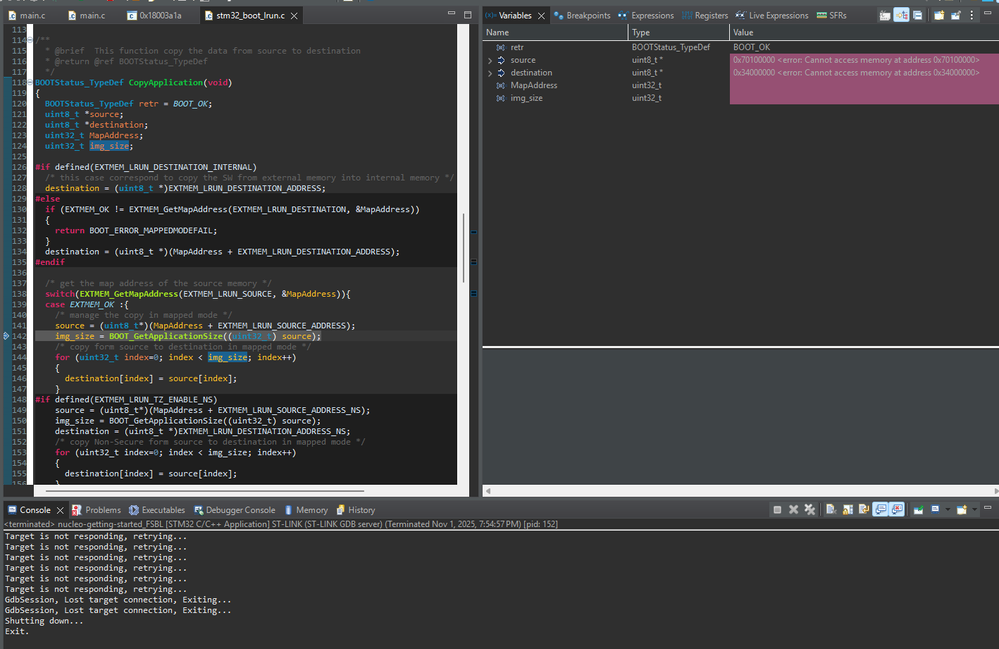

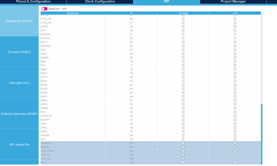

November 1, 2025
Nice tutorial @Julian E. , i experienced the same issue as @YousefDessouki
November 4, 2025
I have had probably the same issue like you when programming the NPU in the nucelo board. I will share with my experience as well as the binary files in a github repo so you can test it.
My main issue was in the external memory mangement unit. in the CubeMx, you should use 0x34000000 as the destination of the source code ,not 0x24050000 as in the tutorial images. Also RIF_Isolation function do not edit it. As for the selection of the NPU in the RIF config tab, this is not an issue. Your main issue is probbaly in the CubeMx ioc files. Make sure to use STM32N6 MCU package version v1.1.1 . You can download it from the CUbeMx itself and make sure to force use it when generating the code.
Below is the github repo link, the binary files u will find them in the debug folder of each of Appli and the FSBL. You will also find the .hex file for the weights. Try using the binary files on the STM32programmer initially.
https://github.com/YousefDessouki/STM32_N6_NuceloBoardwithNPU.git
Let me know if there is any issue :)

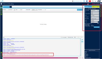

Visitor II
November 26, 2025
Hi @YousefDessouki , thanks so much for sharing your repo!
My deployment didn't work (without any LED toggling and UART), and tried to used your binary instead.
However, the debug folder isn't included in your repo (appli & fbsl / trusted bin).
Do you mind sharing these? I'd like to just at least try directly with the working ones in my board.
Not sure what is happening, but I simply used your repo and build binary & trusted binary files, and programmed it.
Thanks!
