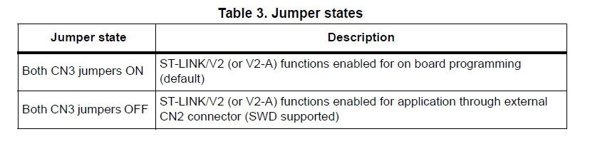

So, first i remove ​CN3 jumper.

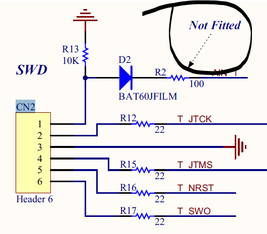

and soldering resistor R2.
but still can't download application. (IAR and st-link is successfully operation)

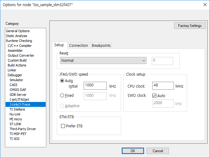

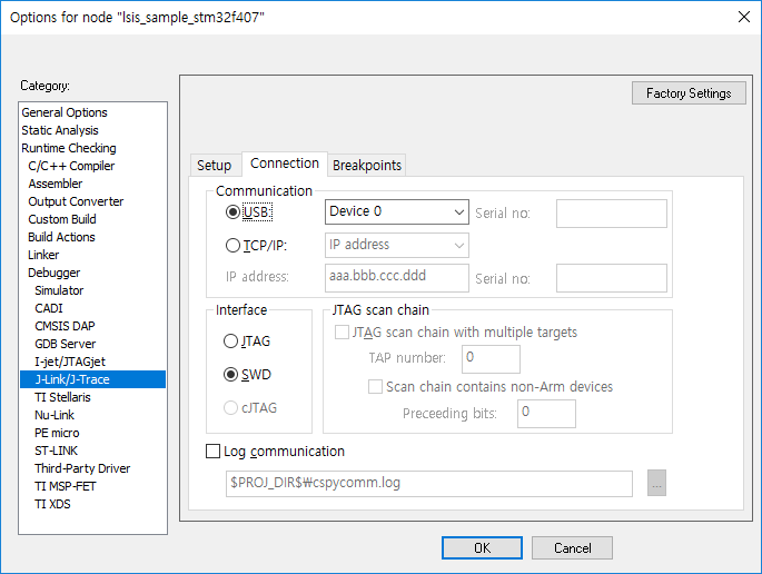

my IAR j-link setting is ...
