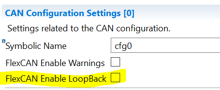

2019-05-14 2:07 AM
Hi Babu,
I'm not sure whether this could help, make sure you have unchecked Loopback! Given that fact that you could transmit, it means you have already did it, but I'm not able to get it otherwise.
Regards,
Prashanth
2019-05-14 2:29 AM
i already did it from board to CANOE. i am able to see the message which are send from board.but if i try the vice versa it fails.
2019-05-14 3:34 AM
