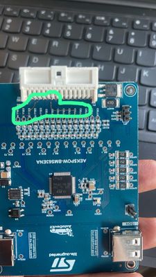

During previous testing, I shorted some unused sense nodes with thin wires in the BMS board pins. The measured DC voltage difference between the unused sense nodes was around 0.02 V, but when connecting or switching the DP711 supply, a sense wire burned and the L9963E IC became very hot. This suggests that the issue may involve the physical holder current path, transient current, incorrect sense wiring sequence, or sense wires accidentally carrying charge current.

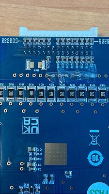

PS: here some images of the sense part got connected and the other one showing the exposed part that got burn

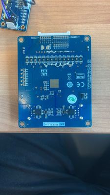

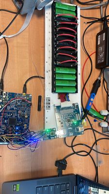

Just to follow up, I am using 6 Cells now as attached below, connecting cell 1-4 and 13-14
  • Soldering Cell 4 to the unused one (5, 6, 7, 8, 9, 10, 11, 12) also shorted S5, B6_5, S6, S7, S8, B8_7, S9, B10_9, S10, S11, B12_11, S12 with Cell 4 (checked using DMM)
  • The unused cells show approximately:
    Cell5–Cell12 ≈ 0.01–0.02 V

    Problem
    When the board is connected but the L9963E is not active, there is no obvious heating.
    However, when the MCU activates the BMS / L9963E starts operating, the board begins to heat. The heating appears to start around the JP1 area, especially around the RG / CGS / RPD jumper region. and also around P3 in the other edge and around senses of Cell 13 and 14
    I tested different JP1 positions and even removed the JP1 plug, but the pins/area still become hot when the L9963E is active.
    Measurements observed
    When the L9963E becomes active:
    JP1 to PACK− ≈ 0 Ω
    Also, measuring across used cell sense paths gives high resistance, around:
    39–43 MΩ
    But across the unused/bypassed region, I measure approximately:
    0–2 Ω
    In particular:
    Cell4+ to Cell13− ≈ 0.5 Ω
    Pack+ to Pack− is not readable in resistance mode.
    Could you please for the AEK-POW-BMS63EN / L9963E clarify the correct unused-cell connection for this exact configuration?

    6 physical cells:
    Cell1, Cell2, Cell3, Cell4, Cell13, Cell14
    Unused:
    Cell5, Cell6, Cell7, Cell8, Cell9, Cell10, Cell11, Cell12

    The board communicates correctly, the GUI connects correctly, and the measured active-cell voltages look reasonable. The issue is specifically the heating near JP1 / RG-CGS-RPD when the L9963E becomes active with the unused-cell bypass installed.
    Any official clarification or recommended wiring diagram for a non-contiguous 6-cell setup using cells 1–4 and 13–14 would be very helpful.
    Thank you.
    PS: attached the GUI which shows the FAULT even though I disactivate the unused Cells! Any help kindly appreciated!
