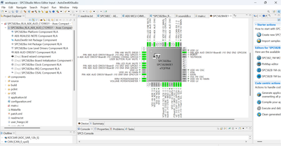

For SPC582B, which development IDE is recommeded for code debug and run? Does PLS JTAG debugger software ok to run some demo when using SPC582B-DIS discovery board?
1 REPLY 1
KTANG.9
We have a SPC5 Studio IDE / AutoDevKit IDE - https://www.st.com/en/embedded-software/stsw-autodevkit.html
Many Sample project
Has graphical pinmap editor to configure the MCU pins.
SPC582B-DIS has built in UDE Debugger on board. You can install PLS UDE Software to connect directly to board.
There is a UDE folder in each sample project which you can use to open a debug.wsx workspace in PLS UDE Software after you compile the project.
