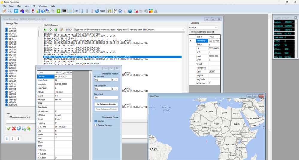

I have connected X-STM32MP-GNSS1 with my STM32MP157F-DK2 board. I have connected it directly to serial COM port on windows to use Teseo-suit.
I updated the firmware for TESEO-LIV3FL to STA8090_4_6_15_1_CP_LIV3FL_UPG48 by using Teseo-suit.
I still can not see my correct position on map. Can anybody please help?
embeddedbro
I need to put the antenna outside and it worked.
