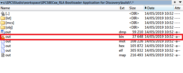

‎2019-05-14 2:01 AM
Hello ,
1) It should be the size of out.bin
You can use this command to check the size of each functions
ppc-freevle-eabi-nm.exe -S -C --size-sort out.elf
400aa030 00000242 T vector52
400b0bb0 000002e2 T FlashCheckStatus
400ae050 000002f6 T can_lld_transmit
400af9c0 0000048c T spc_clock_init
400aed40 000005ee T updater_getData
400acb60 0000071c t can_lld_l1_handler
400ac3a0 000007b4 t can_lld_l0_handler
400ad360 00000c38 T can_lld_start

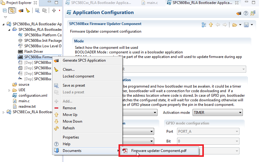

‎2019-05-14 3:51 AM
Hi @Erwan YVIN​ ,
Do we have any application note, or flow chart for SPC560B series on bootloader implementation to better understand the generated code?
Thanks
Prashanth

‎2019-05-14 5:08 AM
Hello ,
You can find in the Reference Manual or in the SPC5Studio Tools suite
Best regards
