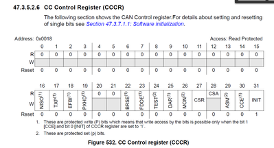

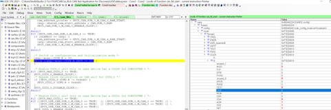

Third question:
In the CCCR control register, the "DAR" bit is in charge of handling the enabling/disabling of automatic retransmission. This bit is set to 0 for default which means that automatic retransmission of unsuccessfully transmitted messages is enabled. (See the Reference Manual RM 0407 of the SPC58 C Line paragraph 47.3.5.2.6 CC Control Register (CCCR))
Finally, the following image shows that by default, low-level CAN drivers configure the DAR register to 0.

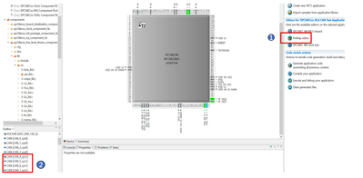

- 1: To link a subsystem to a configuration you have to use the following function:
     can_lld_start(&CAND2, &can_config_mcanconf); /*MCAN SUB  0 CAN 1*/
 where the CAN2 is the pointer to the CANDriver object while
 the can_config_mcanconf is the pointer to the configuration object. There is no automatic assignment of the configuration.
Of course, if you want to link the configuration can_config_mcanconf to another subsystem, you have to use the same function changing the CAN Driver Object that belongs to the new subsystem. i.e.
    can_lld_start(&CAND7, &can_config_mcanconf); /*MCAN SUB 1 CAN 0*/
  Now, to know which CAN driver belongs to a subsystem, you have to:
  - select the Pin Map editor
  - The outline Tab shows all CANs, and the label highlights the subsystem it belongs to. See image below.
In the image above, CAN 4 Sys 1 was selected by selecting pins 70 and 71.
 This choice, after the code generation, enables the CAN7 pointer in the can_lld.c. file to be used in the can_lld_start(....) command.
