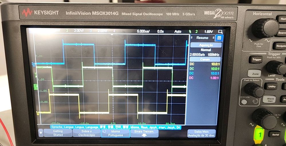

Hello everyone,
I'm working with SPC58 microcontrollers and configuring 6 PWM channels using different eMIOS. The PWM channels within the same eMIOS are properly synchronized, but the channels from a different eMIOS are not synchronized as expected.
I have attached a figure illustrating the issue. How can I configure the PWM channels from different eMIOS to ensure proper synchronization? Are there specific settings or registers I should adjust?
Any insights or recommendations would be greatly appreciated.
Thank you in advance!

void PWMConfig(void)
    PWMconfig[kWH1_ID] = (PWM_Config_t){&PWMD12, CH_WH1}; /* eMIOS 1 Channel 3 */
    PWMconfig[kWL1_ID] = (PWM_Config_t){&PWMD12, CH_WL1}; /* eMIOS 1 Channel 5 */
    PWMconfig[kWH2_ID] = (PWM_Config_t){&PWMD19, CH_WH2}; /* eMIOS 2 Channel 29 */
    PWMconfig[kWL2_ID] = (PWM_Config_t){&PWMD12, CH_WL2}; /* eMIOS 1 Channel 1 */
    PWMconfig[kWH3_ID] = (PWM_Config_t){&PWMD17, CH_WH3}; /* eMIOS 2 Channel 11 */
    PWMconfig[kWL3_ID] = (PWM_Config_t){&PWMD12, CH_WL3}; /* eMIOS 1 Channel 2 */
    /* Initialize and enable the PWM driver.*/
    PWM_start(&PWMD12, &pwm_config_PWM_MOTOR_CONFIG_emios1);
    PWM_start(&PWMD17, &pwm_config_PWM_MOTOR_CONFIG_emios2);
    PWM_start(&PWMD19, &pwm_config_PWM_MOTOR_CONFIG_emios2);
    PWM_setDutyCycle(PWMconfig[kWH1_ID].pPWMd, PWMconfig[kWH1_ID].PWMchannel, kPWM_PWMPERIOD, DEADTIME_BASE, 0); /* eMIOS 1 Channel 3 */
    PWM_setDutyCycle(PWMconfig[kWL1_ID].pPWMd, PWMconfig[kWL1_ID].PWMchannel, kPWM_PWMPERIOD, 0, DELAY_BASE);   /* eMIOS 1 Channel 5 */
    PWM_setDutyCycle(PWMconfig[kWH2_ID].pPWMd, PWMconfig[kWH2_ID].PWMchannel, kPWM_PWMPERIOD, DEADTIME_BASE, 0); /* eMIOS 2 Channel 29 */
    PWM_setDutyCycle(PWMconfig[kWL2_ID].pPWMd, PWMconfig[kWL2_ID].PWMchannel, kPWM_PWMPERIOD, 0, DELAY_BASE);   /* eMIOS 1 Channel 1 */
    PWM_setDutyCycle(PWMconfig[kWH3_ID].pPWMd, PWMconfig[kWH3_ID].PWMchannel, kPWM_PWMPERIOD, DEADTIME_BASE, 0); /* eMIOS 2 Channel 11 */
    PWM_setDutyCycle(PWMconfig[kWL3_ID].pPWMd, PWMconfig[kWL3_ID].PWMchannel, kPWM_PWMPERIOD, 0, DELAY_BASE);   /* eMIOS 1 Channel 2 */
