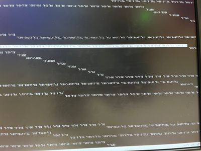

Dear experts,
I am facing an issue when measuring a pack of 14 batteries Fenix ARB-L18-2600. When fully charge 4.23 Volt, the BMS63EN return around 4.0x Volt. When the batteries reduce to 4.12 Volt, the BMS63EN return ~3.98 Volt. Could experts tell me where and how to modify or calibrate the BMS63EN Board?. (I used the Autodevkitstudio-2.4 with both SPC58EC - AEK_POW_BMS63EN_SOC_Estimation_14Cells_GUI application for discovery and SPC58EC - AEK_POW_BMS63EN_SOC_Estimation_Single application for discovery example to measure but they still return same measurement error).

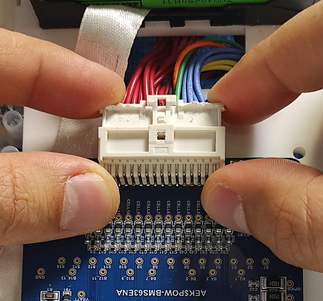

Hi Tri Huynh,
When your board perceives a consistent shift, the device is actually missing the ground reference.
Please follow this procedure:
 1) Disconnect the BMS holder connector
 2) Check both your BMS boards and place each Jumper JP1 in the 1/2 position:
  3) Reconnect the BMS holder connector.
Note: Sometimes, even with the jumpers, this problem happens. That's because the BMS connector is not inserted correctly. Try to reconnect it by pushing along the borders, uniformly, as in the picture:

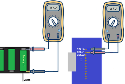

To check if the measurement are right I suggest to compare voltages as in the picture:
If you have any doubts please take a look to the schematic.
You can find it on the UserManual

The current reading is correct but voltage of all the 14 pins still returned errors with the actual is 4.12 and BMS63EN return is 3.98. Do you have any idea or solutions to guide me with this problem?
Thank you so much.

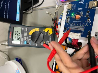

All of the connection from the holder to the board are ok and when I measure by using VOM on pin CELL 1 to 14 with GND_EXT the VOM returned 3.62 volt however the BMS still returned 3.51 volt. I dont understand that I have done something wrong or not?
Best regards,
TH
