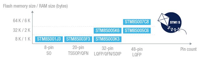

This is a very exciting moment for all of us. STM8 MCUs family was extended with a new device, which is named STM8S001J3. This new family member reshapes STM8 portoflio and takes it to the new level by introducing new, tiny, small form factor package - SO8N.
0690X00000603zLQAQ.jpgSTM8S001J3 belongs to STM8S Value Line series. All STM8S Value line microcontrollers are fully compatible with the existing STM8S product portfolio, sharing the same IPs, key parameter performance and development tools.

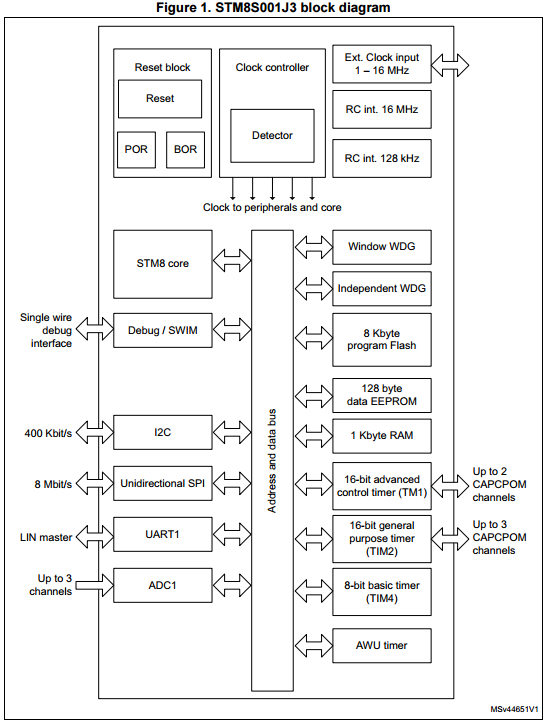

STM8S001J3
has small package and little number of pins, but still it embeds rich set of peripherals. Below some of key features of this device:
  • Core and system
    • Flexible clock control capable to use three clock sources: 2 internal (HSI 16MHz, LSI 128kHz), 1 external clock input.
    • Wide operating voltage range: from 2.95V to 5.5V
    • 5 I/Os
    • 8- and 16-bit timers
  • Memories
    • 8k Flash
    • 1k RAM
    • 128 Bytes EEPROM
  • Conenctivity and debug
    • UART
    • SPI
    • I2C
    • Single Wire Interface Module
  • Analog
    • 10-bit ADC with 3 channels

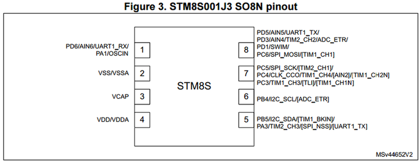

0690X00000607m6QAA.pngAll these peripherals can be used on 5 I/Os thanks to smart multiplexing system.

Indeed SWIM pin (for debugging and programming) is shared with GPIO/peripherals and this is very important to manage this carefully. Once SWIM pin functionality is changed by the application, it is no longer possible to keep the debug session or to program the MCU. This is why we recommend to add few seconds of delay just after the start of application, before configuration of pins is done (so we have a short time slot when debug probe can connect with MCU). Your idea to have a UART command, which configures pin back to SWIM mode is also very good! Thanks for sharing this idea.

A serial console through PD5 using the the UART1 Half-Duplex feature works nicely. Since the UART switches the pin back to input mode automatically this also solves the PD1/SWIM access requirement. Code using this feature is in the
https://github.com/TG9541/stm8ef/tree/develop
(which also adds generic STM8S001J3M3 support).
