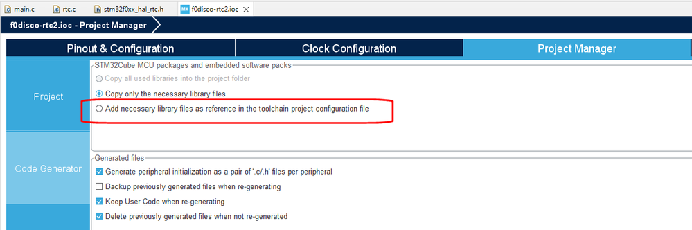

Package management, why to copy all files?
  • January 9, 2025
  • 16 replies
  • 2373 views
I'm highly confused. Coming from Keil MDK, I really enjoyed the CMSIS-Pack approach to manage dependencies. A MCU (and vendor) independent and efficient approach which works in command line and various IDEs (Keil MDK, VSCode with plugin, Eclipse). See Arm Keil Microcontroller Development Kit (MDK) Getting Started Guide, Arm Keil | CMSIS Packs, CMSIS: Introduction, and Arm Keil | Arm CMSIS.
The key advantage was that there's a global config file to define all dependencies (like CMSIS-Core vxxx, or BSP, etc) in a certain version and then the package manager downloads these packages on demand. There's no need to check in all libraries/dependencies into the source control or add them to the source tree at all - they are just linked automatically.
Now that the ST packages all use CMSIS, why do all examples contain hundreds of MB of libraries that could be installed via a package manager? That feels like a huge step back.
Maybe I'm misunderstanding something, there's the "Embedded Software Packages" menu in CubeIDE, but I can't add packages to the current project, so how are they supposed to be used?

An advantage of copying is that your project is self-contained.
It can also mean that you can't get hit by unexpected updates breaking things!
But CubeMX/CubeIDE does give you the option to link rather than copy:

What you want is not supported in the current CubeMX framework. You can add links to folders if you want, and put files there, but there is no "package manager" like feature that will automatically link and download the version of the library you want.
The "Embedded Software Packages" get downloaded into a main repository folder and from there are copied to your project folder on code generation. If you want to do this manually, you can link to the repository folder instead, but this would be a manual step.
Not in the ST offering, but users are free to bring their own package/repository management. ST did a great job re-structuring and re-packaging the STM32 libraries on github. Now the CMCIS device part is in a separate git sub-repo (module), "HAL drivers" and middlewares are in separate sub-repos, and more components are available in the "software pack manager".  There are known tools to manage multiple repositories of different nature (git, lfs, artifactory....). Of course it takes time and effort to create a project with that. ST makes chips, it would be naive to expect from them to supply this functionality. On the other hand, Keil, IAR provide software solutions that are worth their price.
So back to STM32: one can pull the STM32 libraries from github as submodules, and make the app project link/refer to these libraries. They won't pollute the user app project. But there is  a prominent warning in the "HAL" library documentation about dependency on certain CMSIS version! You cannot just pull it the latest CMSIS from ARM. Otherwise - the system works :)

Maybe we are talking at cross purposes. You don't need to copy the libraries into your project and you don't need to download the libraries for every project. If you start a project for an MCU you never used before, CubeIDE downloads all libraries for this MCU, put in into a local "repository" and you have to link (not copy) all the files you need, referenced to the library folder. You can add the library folder to the search path list and simple include the files. When starting a new project for the same MCU family, all libraries are already there.
The backup of a project only contains the user code, not the libraries, but the references to the library folders. After restoring the backup you have to check if the libraries are present in the right version.

So we have two almost unrelated discussions here:
(1) You acknowledge that CubeIDE does not come with a decent package manager like ARM (Keil) has. That's fine if we compare their price tags and target audience. So much about CubeIDE.
CubeIDE itself is just Eclipse CDT. It will happily build, edit and debug a suitable Eclipse project, generated by CubeMX or whatever else. CubeIDE comes with some 'team' components inherited from Eclipse. One can use these or use whatever they like.
(2) Are poor CubeIDE users doomed to keep everything in one version control repo? No they do not. CubeMX (standalone or CubeIDE internal) and its Software Pack manager does not help creating well structured projects - but other means exist for this. Professionals know their tools.
For every STM32 MCU and eval. board, ST offers a consistent package that lets quickly make tests or POC applications. Not more, not less. It is good for users, good for marketing, good for support, mostly free of 3rd party licensing troubles. Is this also good for real application development? Of course it is not. ST does not want to compete with their software ecosystem partners.  That's fine.
