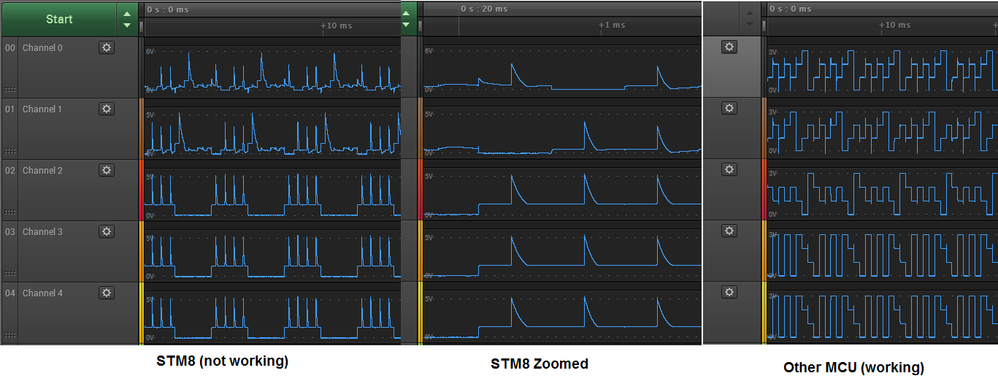

I have a custom LCD that I am trying to drive with theSTM8L052C6. I have tested the LCD with 2 other MCUs and it works fine. However, when I try to drive it with the STM8, it is very dim and almost not visible. I probed the pins on another MCU that works and compared it with the STM8 trying to drive it.
This image shows the STM8 vs a working MCU. For some reason, the STM8 will drive to the correct voltage briefly then will drop. I'm not sure what could be causing this. I have tried to change parameters in almost every LCD related register.
Any ideas would be greatly appreciated. I've been stuck on this for quite some time.

Check VLCD
-NC

waclawek.jan
Posted on January 06, 2017 at 15:21
Setting
LCD_CR2
.HD would not help?
Billy Bob
Posted on January 13, 2017 at 06:26
Thanks for the response. I tried setting that bit again just to be sure. For some reason, when that bit it set, the LCD is nearly invisible. It might be completely off. I don't have my scope with me to check, but it seems to make the problem worse.   Any other ideas as to what could cause this?
Posted on January 13, 2017 at 11:50
No.
Don't you have by any chance a STM8L Discovery? It has an onboard LCD and you could check the waveforms and the response of LCD to various settings there easily.
nestor
Posted on January 13, 2017 at 12:57
Check VLCD
-NC
Posted on February 15, 2017 at 10:30
Thank you!
The problem was that I didn't have a capacitor placed on the VLCD pin. This was frustrating because it seemed like things would sometimes work, but if I slowed down the clock or even enabled LCD_CR2.HD the display would appear off. With the capacitor in place, it works fine.
