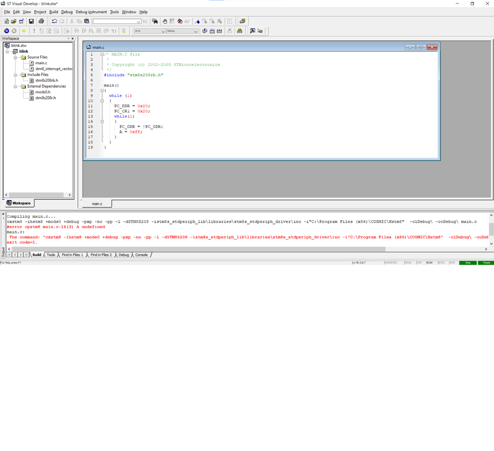

Hello
How can I access CPU registers using the Cosmic compiler?
For example, when I access register A, the compiler throws an error A is undefined (This is shown in the picture and also the project files).
    Best answer by Ans
    You've to define address for any register. Check datasheet and see what's the address of A register and then define it accordingly.
    Checkout this guide: https://lujji.github.io/blog/bare-metal-programming-stm8/
    mƎALLEm
    November 28, 2023
    If "A" is a an internal core register you need to access it in assembly language.
    If "A" is a peripheral register you need to define the address of "A" and access it by pointer in C.
