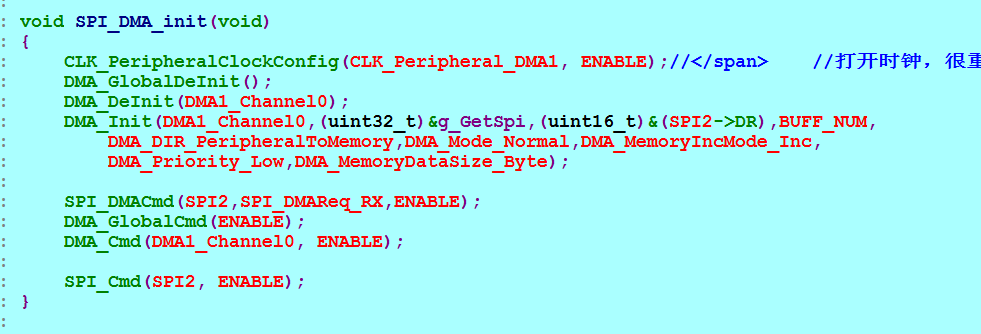

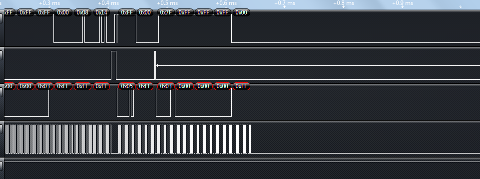

Hi ,I have a question about the STM8L using the DMA to get the SPI data, it is using to get the Flash data from W25Q80 and when i try to get the flash with DMA ,it is ok. it is thanks very much�?
