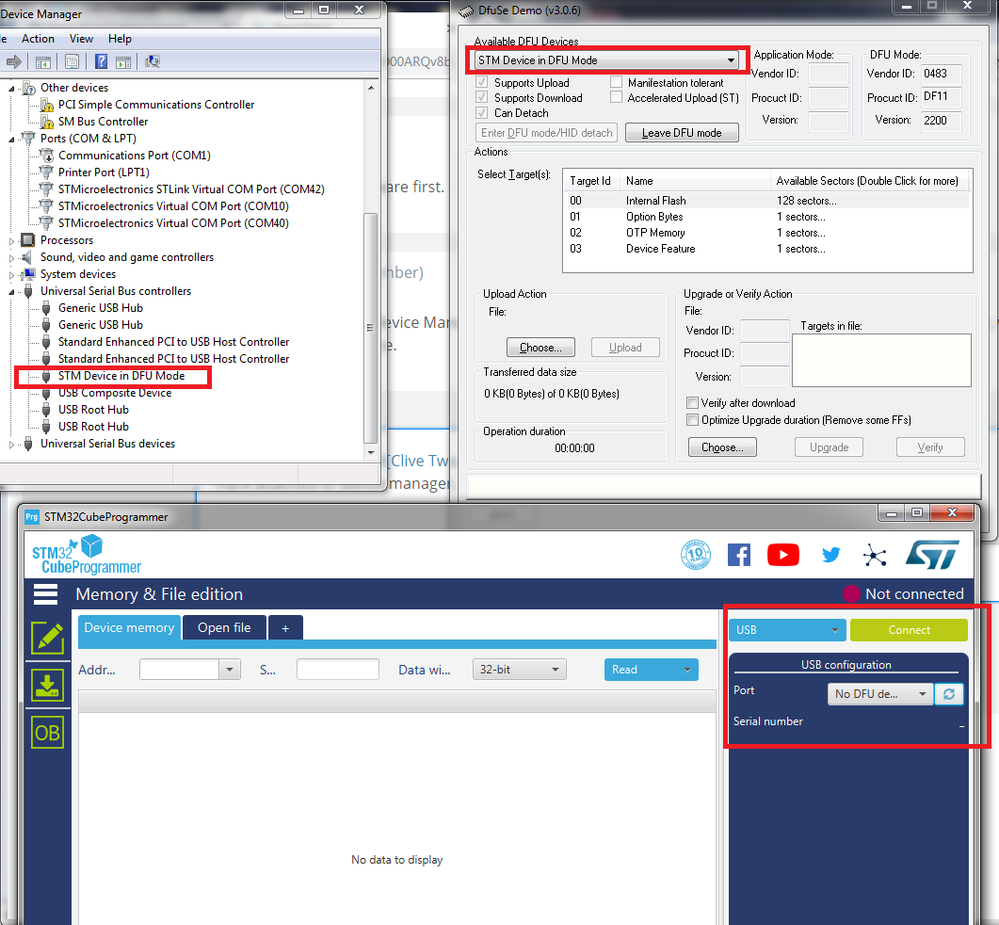

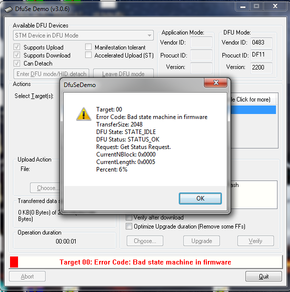

stm32l432kc shows bad state machine in firmware when tries to upgrade code in dfu mode using the same code with the same file.
‎2019-03-04 8:22 PM
Thanks for your reply @Community member​ ,
Here I attached a snap of device manager, Cube programmer and DFU-SE demo.
Thanks and Regards,
Swapnil

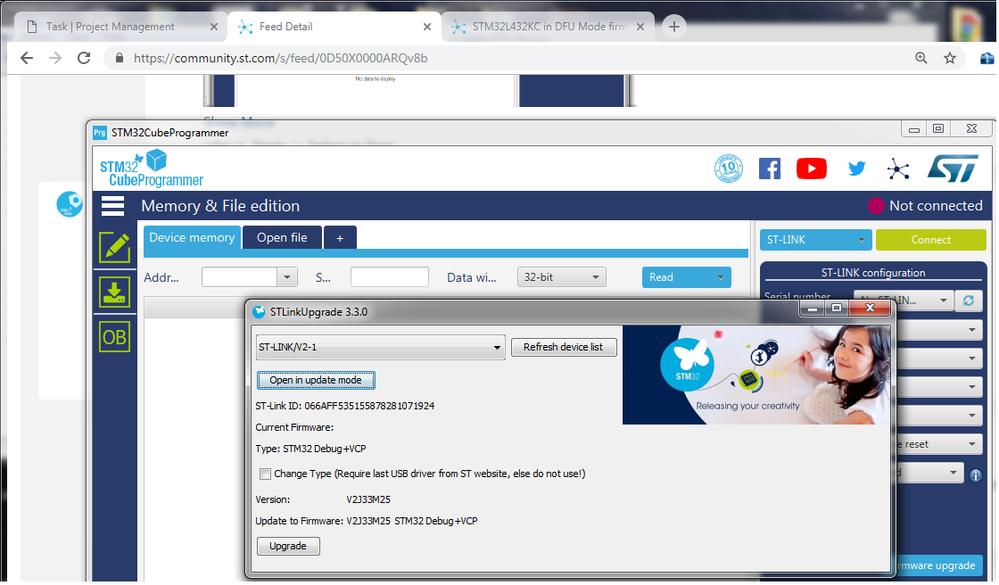

‎2019-03-04 8:34 PM
Thanks for your reply @Amel NASRI​ ,
My device has been detected as STLINK mode but not as DFU mode after before and after upgrading Cube programmer and Device firmware software. I attached a snap of my device firmware version hereby,
Thanks and Regards,
Swapnil

‎2019-05-09 3:14 AM
​Hello @swapnil champaneria​ ,
Sorry for the late repons.
Could you plz try with last version of STM32CubeProgrammer :2.1.0.
Tested for my side and it is OK.
Please let me know if you still have the same issue.
regards,
Houda

I know this is an old thread, but I'm having the same issue. I believe my problem is with USB signal integrity. In my case, I changed layers on the USB traces on a 4-layer board with a ground and power plane. The return path for the USB signals has to find the nearest bypass capacitor which is 0.25" away. I may also need to monkey with my trace width to get closer to 90 Ohms (Right now I'm at 100 Ohms).
