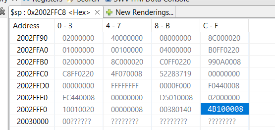

By placing a few strategic breakpoints, I can see that once the option bit write takes place, printf starts causing an endless reboot cycle. Code in main() executes up to the first place printf() is called, then it reboots.
Looking at disassembly, I can see a point where a "bx lr" jumps into the middle of the boilerplate startup code, so I don't think an actual fault or reset is occuring; it's more likely a case of stack corruption. However, the situation persists through hard resets; I can only regain control of the chip by using STProg to clear the BFB2 option bit.

Oh sorry, I should've included the code that far back. That's just the top of the loop that increments the timer variable. I'll edit the post to include it.
Screenshot: Stack while the code is flowing through that loop.
0693W00000WHuKJQA1.pngThe only activity on the stack is the storage for the 32-bit counter variable; the stack pointer doesn't move in this section of the code.
When it stops on ResetHandler, check the PWR reset reason register. Can it be watchdog?

OH MY $DEITY I SOLVED IT.
Based on this one short paragraph in AN4767 that I managed to gloss over before:
"Beware that the VTOR reset value is zero, in case of BFB2 option active, it will by default point to system memory."
So yes, of course, if BFB2 is set and VTOR isn't re-pointed appropriately, the very first interrupt that comes along after the bank switch will send execution back into system memory. That's why I first saw it in the context of printf, which led to UART interrupts.
If the first instruction in main (or, really, any that happen before an interrupt) properly point the VTOR back at 0x0800 0000, the core stays happy in application code.
