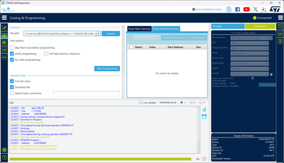

I have just received my STM32N6570-DK and tried to flash the external memory
Whatever I do :
* program an Hex file
* erase single sector
* erase full memory
I always have the same error : failed to erase memory
I have tried to revert cube programmer to version 2.19  but I still have the error.
The bios of the board has been updated
Any idea of what to do ?

I'm having a similar issue and I'm unable to erase my STM32N6570-DK.
I am in Boot mode 1, as described.
But the Erase Tab in CUbeProgrammer is empty. Also flashing seems to be broken, as it reports me that flashing was successful, but after a reset (and going back to Boot1=0) it will just go on with the demo application and ignore my firmware.
And erasing via CLI is also not possible:
$ ~/st/stm32cubeclt_1.19.0/STM32CubeProgrammer/bin  ./STM32_Programmer_CLI --connect port=swd mode=HOTPLUG ap=1 -el /home/user/STMicroelectronics/STM32Cube/STM32CubeProgrammer/bin/ExternalLoader/MX66UW1G45G_STM32N6570-DK.stldr --download /home/user/Documents/zephyr/stm32n6/zephyrproject/zephyr/build/mcuboot/zephyr/zephyr.bin 0x70000000 --start

Erasing external memory sector 0
Error: failed to erase memory
Any idea whats causing this?
I at least to some extent found the error, as I wasn’t able to flash. My path had a broken signing tool, which caused the image not to be signed by my build system.
But it is strange that there is no warning or error when you try to flash an unsigned image. I would have expected this instead of a simple “flash successful,” which wasn’t true. Maybe that’s something you want to look into, as that sounds like a bug to me.
Oddly enough, I still can’t erase the flash, as no registers are displayed in CubeProgrammer. I probably won’t look into that anymore, as I’m now able to flash something.
