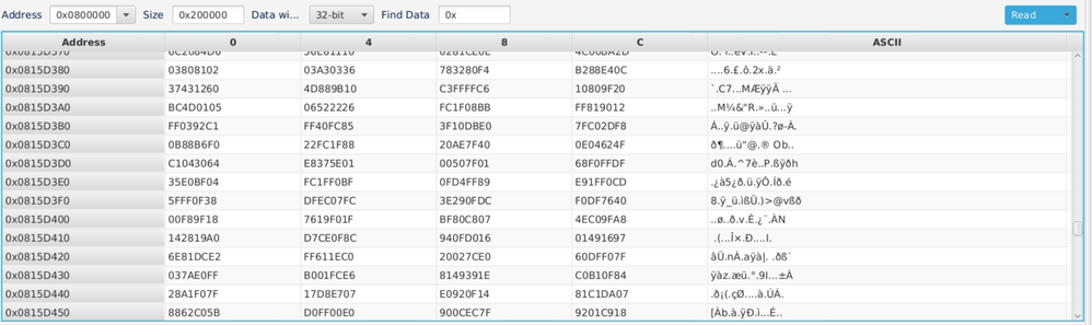

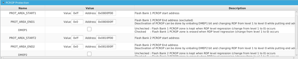

I'm facing this weird behavior with many STM32H7A3ZIT6 parts, where after we flash our Firmware, the MCU do not work and when we read the flash content, we can notice that one flash bank (1MB) is either corrupted with random data or erased. Sometimes we see Bank 0 in this state, other times Bank1.

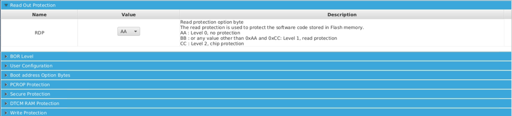

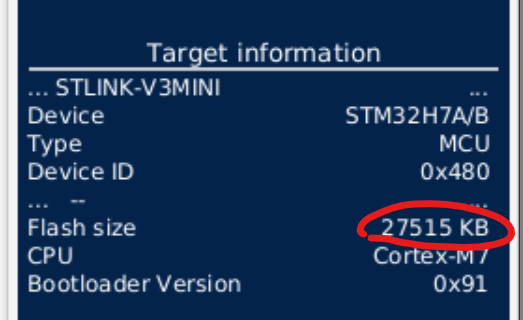

When this happens we check using STM32CubeProgrammer, the option bytes are normal (no read or write protection is checked), and more interestingly is that STLink returns a weird Flash Size Value
First Bank with random data

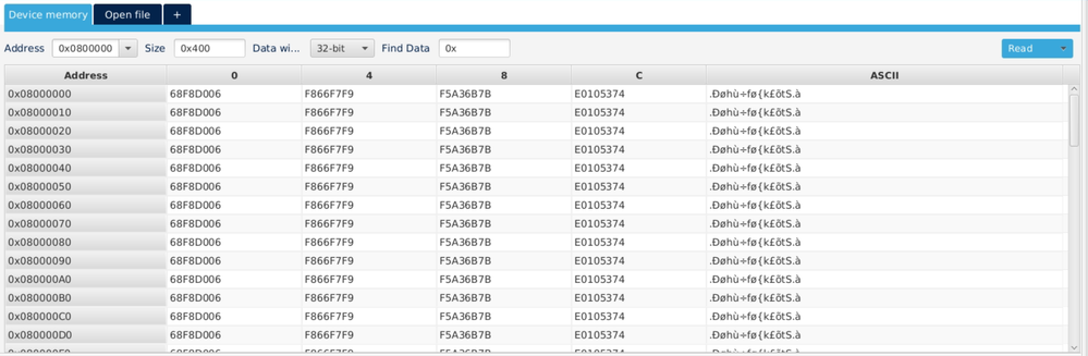

Second Bank is normal (has valid code)
Invalid Flash Size (After mas erased this reads Ok, but fails again after FW is flashed)
While flashing the code, the STM32CubeProgrammer returns success, even though we can't read one of the banks properly.

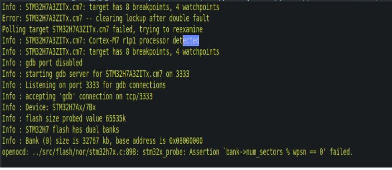

I've also tried flashing using STM32CubeIDE with OpenOCD but the problem persists.

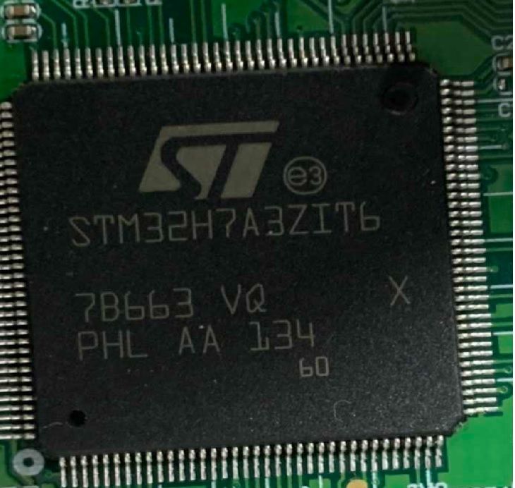

Below is the image of a Chip we are using
Option Bytes
I could not come to any conclusion so far, and I'm afraid the MCUs with this issue are bricked forever.

Strap BOOT0 HIGH, and fully/completely power cycle the core several times, to ensure your code is not run.
The check with STM32 Cube Programmer directly
Check what you're doing with LDO / SMPS settings, and VOS settings in SystemClock_Config()
DReis.2
@Community member​ When the MCU enters this state, and I remove all power supply and wait, I'm able to write the entire flash, but eventually the problem appears again after running for awhile
The MCU part I am using is LDO only, configured with VOS0 for 280MHz
Below is the SystemClock_Config() used.
