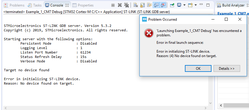

Hello;

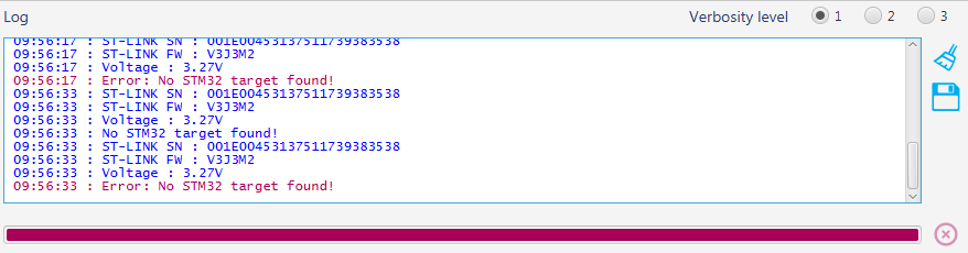

I can't program and debug with the STM32H747 Discovery kit. I tried Stm32cubeProgrammer and STM32CubeIDE for this. Below are the errors I have received in both.

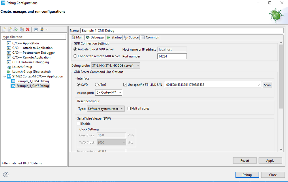

Debug configuration screen is below;
STLink Serial number appears, but I can't understand why it can't program it?

If you've screwed up the LDO/SMPS and/or VOS settings it will brick the board.
The recovery method in that case is to solder a link on the BOOT0 pin so it is high. Then cycle the board power completely (remove all connections/power sources) several times, until you can connect.
Check you can connect with STM32 Cube Programmer or ST-LINK Utilities, and then Mass Erase your code from flash.
On the H747I-DISCO I had, access to BOOT0 was via a small resistor pad (R192) under the screen. You'll need to check docs for current board to confirm.
Then, once recovered, stop putting code with broken settings on it, or provide secondary methods to stop the clock/system configuration code running.

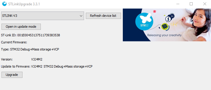

The result has not changed, although I have implemented the document step by step. I updated to see if there is a problem with the STLINK version. But the result did not change again.
Version information is below;

Hello @Markus GIRDLAND (ST Employee)​
In addition 2 of 4 discovery boards are in this case.

And you can't connect through STM32CubeProgrammer either? Then I would check power/cabling and make sure your computer can detect that the board is connected, I don't believe it's CubeIDE related more likely board/HW related.
It might be in low power mode as well, then it could help to "connect under reset" through either CubeIDE or CubeProgrammer.

Hello @Community member​
Problem is solved. I have a few questions to fully understand the source of the problem.
