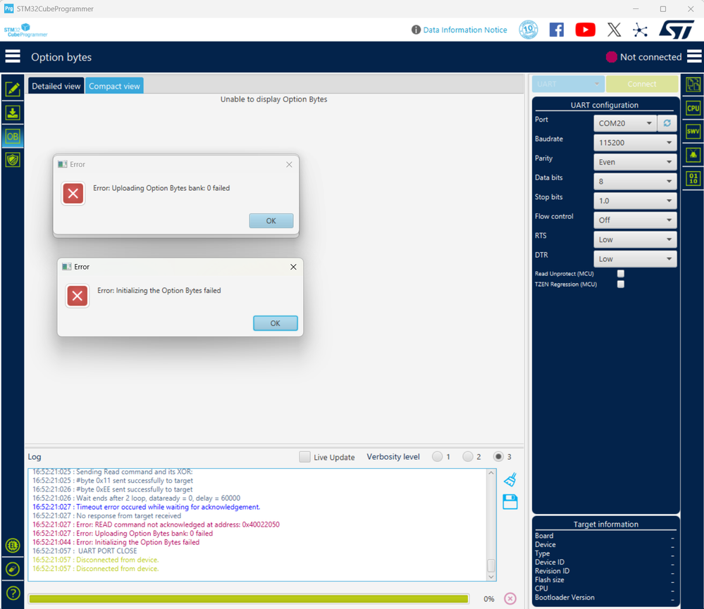

STM32H563: CubeProgrammer UART connect fails in PRODUCT_STATE = iROTProvisioned
‎2025-01-17 9:39 AM - last edited on ‎2025-01-20 6:36 AM by Andrew Neil
STM32H563 chiprev Z.
I am trying to work through How to start with OEMiRoT on STM32H573 and 563–Arm® TrustZone® enabled - stm32mcu using a NUCLEO-H563ZI MR1 board but using the latest STM32CubeProgrammer (2.18.0) and ST32Cube_FW_H5 (STM32Cube_FW_H5_V1.4.0).
Section 2.5 is intended to demonstrate booting securely and then dropping into the System flash bootloader from non-secure application and connecting to it via UART. In my case, I use the virtual COM-port provided by the ST-Link provided on the board. I have not dared to go all the way to CLOSED but have chosen to tell the provisioning.sh that I want PROVISIONED state. I have confirmed using the SWD-connection that the TZEN is enabled after this and that PRODUCT_STATE is iROTProvisioned.
I type 1 in the terminal displaying the "UI" of the non-secure app and then disconnect TeraTerm and in ST32CubeProgrammer I select connect method UART and Port = COM20, Baudrate = 115200, Parity = Even, Data bits = 8, Stop
bits = 1.0, Flow control = Off, RTS = Low, DTR = Low. Except for the COM-port-number these are the default settings.
When I click Connect the application talks to MCU and from the log I can see that a number of GetID commands succeeds and then it issues (to my understanding) some Read Memory commands and then does GetID again and now this command times out. After a while it will fail popping 3 dialog boxes with texts
"Error: Initializing the Option Bytes failed"
"Error: Uploading Option Bytes bank: 0 failed"
"Error: RDP is set to level 1 or target is held under reset, try using Read UnProtect (-rdu) command in order to remove the Read Out Protection"
and disconnects.
If I do a regression back to OPEN using certificate-based-DA and launch the bootloader by connecting BOOT0 to VDD and power-on-reset connecting STM32CubeProgrammer works. I have not tried to actually write memory.
I have 2 questions
1) Is this some kind of known issue in the bootloader of STM32H563 and/or STM32CubeProgrammer?
2) Even if connection was possible in PRODUCT_STATE = iROTProvisioned, would updating the non-secure app via this bootloader actually work? My understanding of AN3155 rev 16 table 2 is that the "Write Memory" bootloader command will not be available when protection is active. And reasonably it should be in this scenario unless dropping to the bootloader magically lowers HDPL (but that should not be possible without a reset).
As a side note, I am guessing that the text on page 8 about when Protection is on for STM32H5 is misleading. It should be probably state that TZ is enabled which means that the TZEN option byte is B4. If Write Memory was available here, it would still need to be a no-op if you would try to write the OB Keys or the OEMiROT (replacing it with something that doesn't verify S/NS apps).
The correct way of updating the apps when Secure boot is enabled should be In-app programming as outlined by AN4657 and not the bootloader in System flash, right?
Would be great if someone could tell me if I am correct or if I have misunderstood something here. I am pretty new to both this line of MCUs and Secure boot on embedded in general.
Best regards, Jesper

‎2025-02-28 10:58 PM
Hello JesperEC,
I am facing the same issue. Have you resolved this issue yet?
Best Regards,
Perorin-Q
‎2025-03-03 3:17 AM
Hi @Perorin-Q,
I have not resolved it unfortunately. It is not clear for me if the built-in bootloader is intended to be usable in this scenario and how it can be done without opening up a back-door in the secured booting chain.
I have filed a support case on ST to hopefully get some attention on the question.
‎2025-04-24 8:26 AM
Hi @JesperEC and @Perorin-Q ,
I have exactly the same problem. Did you have any answers from ST or did you find a solution ?
Kind regards,
Lionel-LMS.
