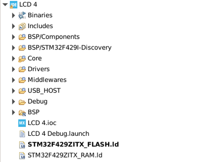

After a long time I finally just decided to include the BSP/Components directory and the BSP/STM32F429I-Discovery directory to my project, add the include paths, and add the two folders to the source location.

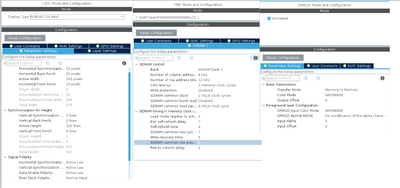

I found an example in my /STM32Cube/Repository/STM32Cube_FW_F4_V1.28.1/Projects/STM32F429I Discovery/Examples/BSP directory, and tried copying the code that involves the LCD from main.c over to my project and run it. The LCD still never displays anything. I have also tried playing with the configuration values of FMC, LTDC, DMA2D to see if that helped. It didn't. I suppose these configuration settings are actually important for the LCD to work properly. Here are the current settings: -
I appreciate any help I can get. I cannot find anything on the internet about this.
