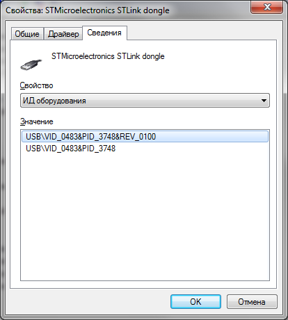

The ST-LINK / V2 programmer is not detected on my PCs.

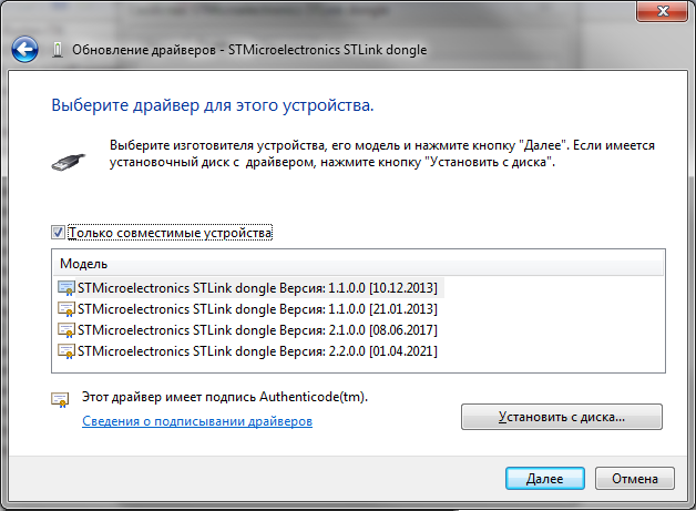

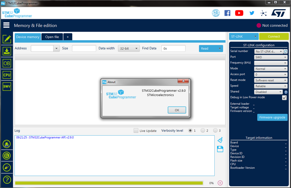

Before that, when I had a win7 x64 PC with a core i5 processor - STM32CubeProgrammer worked. I currently have a Ryzen 3600 win7 x64. I have installed the latest STM32CubeProgrammer 2.9.0 and am getting "no st-link detected" error. Moreover, through the STM32 ST-LINK Utility, the programmer is detected and works. Everything works through STM32CubeIDE too. I tried all possible driver versions, still no st-link detected. I tried different versions of STM32CubeProgrammer both x64 and x86, still no st-link detected. I tried various USB ports, both USB 2.0 and USB 3.0, tried different ST-LINK / V2 programmers (I have several of them), I even tried on another PC with the same configuration (Ryzen 3600 win7 x64), I still get an error no st-link detected.
Why is that? What else do I need to do to make STM32CubeProgrammer work on my PC?

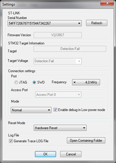

As I wrote, this programmer came out works great with ST-LINK Utility and STM32CubeIDE. Only stm32cubeprogrammer does not work.

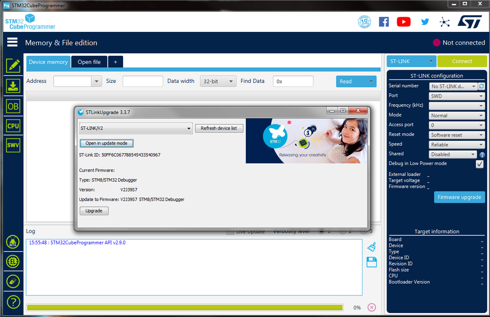

Moreover, if in STM32CubeProgrammer I go to "Firmware upgrade", the programmer is detected and updated, but the programmer is not displayed in the "Serial number" list ...
