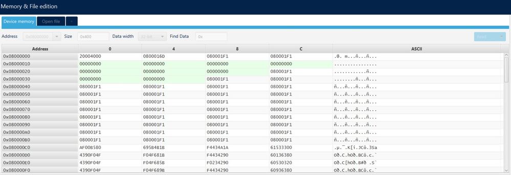

First thing I noticed is, that after pressing the reset button the code jumped right into address 0x080001f0 which is the WWDG_Handler. After pressing "step into" it jumps to address 0x080000c0 which is a line in the main function and then back to 0x080001f0.
As I didn't activate the watchdog and also checked the WDGA bit which is set to 0 (inactive) with the CubeProgrammer register view, I'm wondering if this is a watchdog related problem or if there is something wrong with the vector table/ startup code?
Furthermore I got a lot of errors above the address 0x08000000 and undefined areas inside the WWDG_Handler and further below, but I don't really know why...

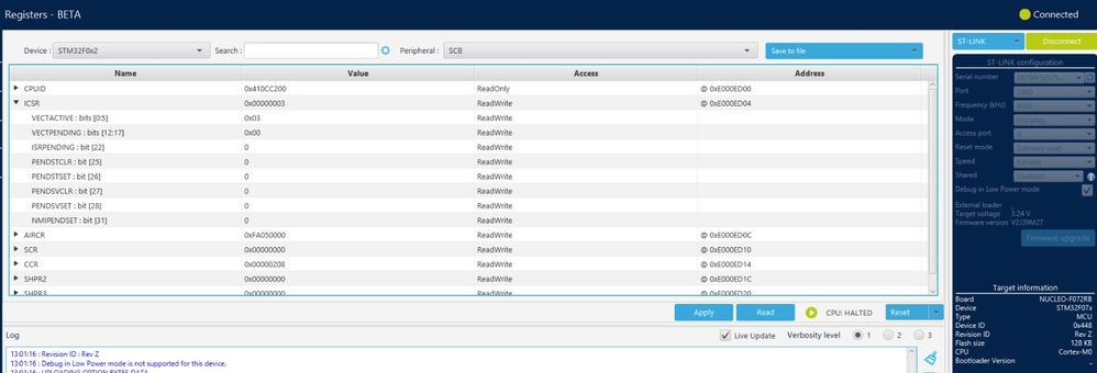

You have redirected all interrupts to one single ISR, so you cannot distinguish which interrupt it was. Either write individual ISRs, or when in the ISR, read out SCB->ICSR ( 0xE000ED04), the bottommost 10 bits (VECTACTIVE) field show the current interrupt's number - post it.

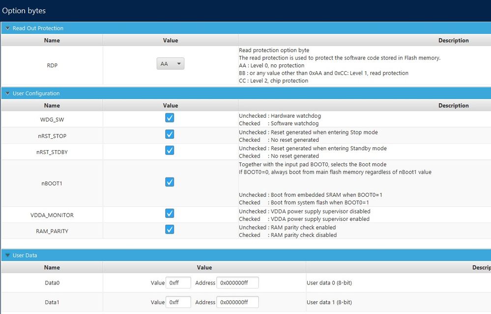

Do you use the built-in bootloader?

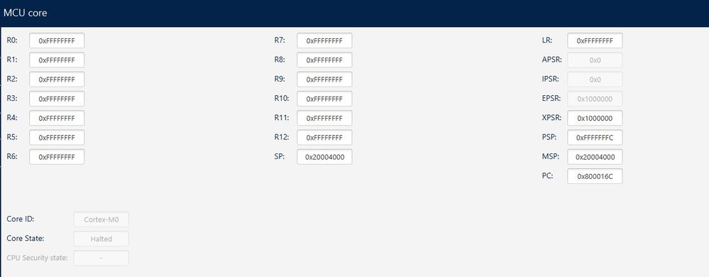

What is SP's content?
How are Option Bytes set?
Flo
The CubeProgrammer says there is 0x03 set for the VECTACTIVE field. In the reference manual I cannot find any information regarding this register...
SP points to address 0x20004000 (located at 0x08000000). I cannot access this address with the CubeProgrammer so I don't know the content.
I thought by don't utilizing anything except of the CubeProgrammer I don't use the build-in bootloader? Can I verify this somehow? I see no settings in the tool for this.
Option Bytes are also unchanged from default:
RDP: AA
User Configuration: All checked
Data0: Value 0xFF, Address 0xFF
Data1: Value 0xFF, Address 0xFF

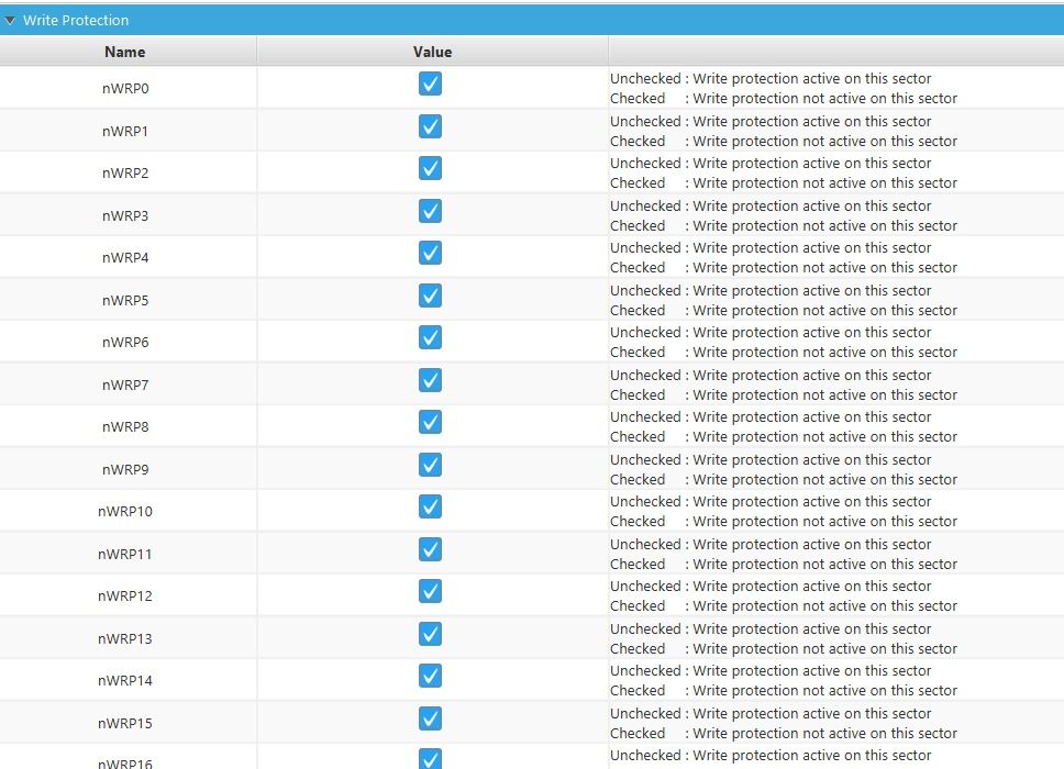

Write Protection: All checked

waclawek.jan
That's because it's register of the processor core, and that's documented in the so called Programming Manual, for Cortex-M0 in PM0215.
3 appears to be HardFault. Now the problem is, that you apparently look at the registers (namely SP) while in reset state, so that won't give much information on that.
I don't think CubeProgrammer is the best way to gain insight into the mcu. You've appeared to have get CubeIDE working, sort of, so try to stick to that one, and look at the content of stack (where SP points) after running the code. Or try to single-step instruction-by-instruction, perhaps in the disasm window (I don't use CubeIDE so I don't know how exactly that works) and observe where does it go and how the registers are changing.

The only thing that could be of any value is, that I cannot access addresses above 0x20003FF0 in the CubeProgrammer and get an error if I try to. As the stack pointer should be at 0x20004000 maybe this causes the hardfault?
But if so, why is the border this address? RAM size should be 16k and end of ram therefore at 0x20004000 not 0x20003FF0.
