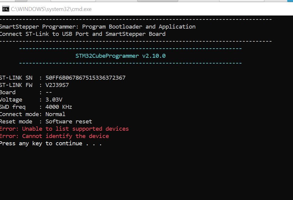

CubeProgrammer under Windows (graphical Version) is working fine.
CubeProgrammer with Cmd Line brings error:
Output
STM32CubeProgrammer v2.10.0
ST-LINK SN : 50FF6B067867515336372367
ST-LINK FW : V2J39S7
Board : --
Voltage : 3.03V
SWD freq : 4000 KHz
Connect mode: Normal
Reset mode : Software reset
Error: Unable to list supported devices
Error: Cannot identify the device
Press any key to continue . . .
This is my command in Batch File:
STM32_Programmer_CLI.exe -c port=SWD -vb 3 -e all -w SmartStepper_BootAndAppl_Vn_nnn.hex
pause
My hardware is a STM32G431 with ST-Link V2 Iso. Hardware is completely working with the graphical version or with Keil debugger.
Thanks for any idea

2022-04-13 1:18 AM
I found the problem. The cmd line program works only in the installation file. As default ST uses this path: C:\Program Files\STMicroelectronics\STM32Cube\STM32CubeProgrammer\bin
Because this path uses spaces. In a batch File a space is not allowed.
My solution:
I installed ST Cube Programmer in this folder:
C:\ST\STM32CubeProgrammer\bin
And then I made a batch in my project folder:
@echo off
cls
echo ----------------------------------------------------------------------------------
echo SmartStepper Programmer: Program Application only (without Bootloader)
echo Connect ST-Link to USB Port and SmartStepper Board
@echo on
C:\ST\STM32CubeProgrammer\bin\STM32_Programmer_CLI.exe -c port=SWD -vb 3 -e [4 15] -d build\SmartStepper.hex -rst
In my project: Sector 0-3: Bootloader, Sector 4-15: Application
This batch file I call from my Keil developer system (because internal flash loader has problem if Flash cannot be erased complete)
Find the the Keil installation on top.
