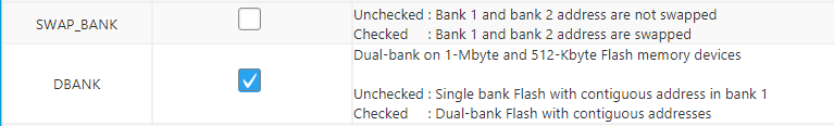

I've been using a STM32U585 Discovery kit for a few days and have succesfully run several programs on it. However today I suddenly got this error in STM32CubeIDE when trying to run a new program:
Error: Data mismatch found at address 0x0800899C (byte = 0x31 instead of 0x33)
Error: Download verification failed
Trying to upload different programs gave the same result, but with the mismatch at different addresses.
Using STM32CubeProgrammer I can erase the flash completely and then normally upload and run code with CubeIDE once, but after uploading a different program again I will get the same error.
I've upgraded the ST Link firmware, no change.
I would appreciate any help in finding the problem as I don't want to use CubeProgrammer to fully erase flash every time.

It seems an option byte was somehow switched.
I tried different combinations of SWAP_BANK and DBANK and this is what works for me now.
Hopefully this will help someone with the same problem.
