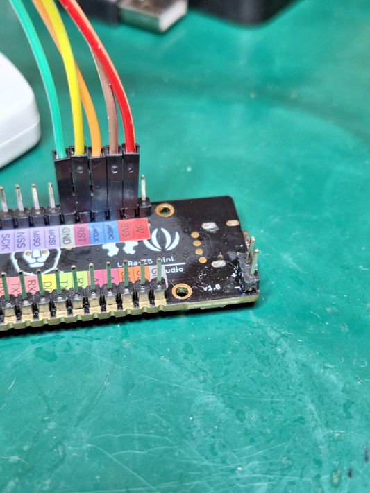

I forgot that I must use ST-LINK/2 device attached to USB and connect appropriate pins between this device and the WIO device.
I have used the last working pin connections between ST-LINK/2 device and the WIO device, and for now, I'm a little bit closer, I think.

I don't understand how there can be such a small voltage measured by the ST-LINK/2 device. I checked the connections between devices twice, and everything looks fine.

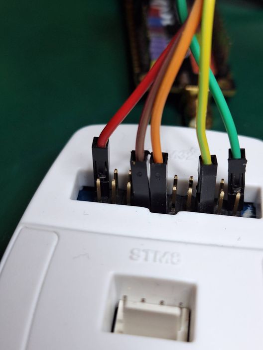

Pins look connected properly. ST-LINK/2 VCC pins are 1 & 2. GND is the green cable.
I have used such connections earlier.
Do you see something wrong?

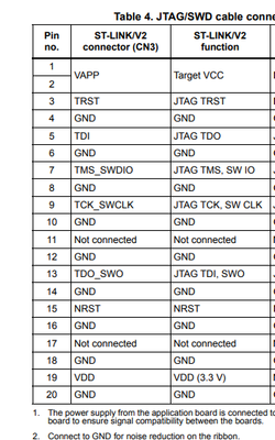

ST-link V2 giving no power...VDD connection is just for measuring the target voltage.
So give some 3v3 to the ...target. st-link will show then this voltage.
...if this is correct:  pin 19 giving 3v3 , pin 1 is for checking the voltage (this it shows then)
from manual:

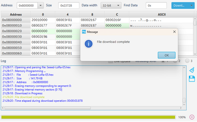

So I pressed the reset button on the device, and having pressed it, I pressed the Connect button on the IDECubeProgrammer, and voila, it works now.
And I was able to reprogram my WIO device.
Thanks for all supporting me in this Return Back operation :)
