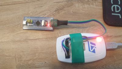

It seems I have the same problem
Although I agree ST should protect their product I would expect it would prepare the customers for this decission. I used to buy STF103 MCU and ST Link V2 ( "fakes" ?? ) from fastest supplier not really looking if original or not...
I have an original ST Link V2 from ST on the back is [B 2022 48 ] just purchased 2 days ago from Digi Key ( your trusted supplier/distributor ).

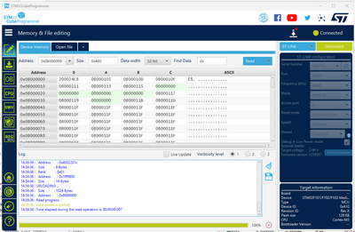

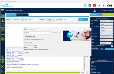

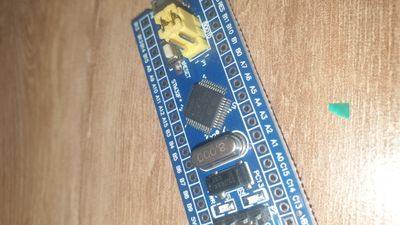

I have several bluepills STM32F103C8T6 that in the STM32Programmer are visible, can connect and read memory. Amyway, when I connect to STM32CubeIDE I get the error "Cound not verify ST device !" or "No STM32 target found!".
Can anyone suggest an issue??
The ST Link V2 FW after update is ... V2J43S7
It can read memory in STM32Programmer
In STM32CubeIDE it does not connects ...
 A photo with hardware - all seem original.

@CSand You are trying to access a Blue Pill with STM32CubeIDE via what appears to be a genuine ST-LINK/V2. Why would STM32CubeIDE program a fake MCU that it doesn't know?
And in case it's not clear to you, although it has been discussed here many times: there has been no Blue Pill with original STMF103 for years.
Regards
/Peter
‎2024-01-11 5:13 AM
Look on your bluepills : whats exactly written on the chip ? + logo ?
I have some CKS F103 , also GD32F103 - these are good cpus, but NOT by STM !
So IDE now checking: is it by STM ? if not - refuse to work.
‎2024-01-11 5:20 AM
What is written as logo or marking is of little relevance because the average user can hardly see the subtleties. In the best case scenario, it would be important to check that the chip is an original, which has also already been discussed here.

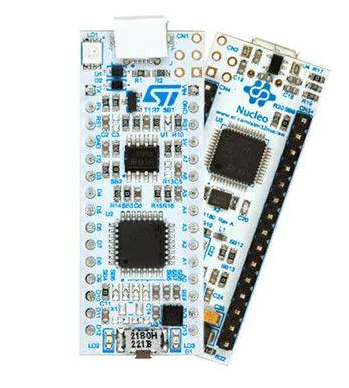

Blue Pill is a board from an Asian manufacturer, but was never (officially) supported by STMicroelectronics.
Instead of the undoubtedly very inexpensive Blu Pill (now you know why it is so inexpensive), I recommend the universally applicable NUCLEO boards, which are available with many different MCUs and in three sizes: NUCLEO-32, NUCLEO-64, NUCLEO-144. You'll find some overview e.g. in the user manuals or in:
Most NUCLEO-64 even have a detachable ST-LINK/V2 that can be used to program or debug other target platforms.
Good luck!
/Peter
‎2024-01-11 8:30 AM - edited ‎2024-01-11 8:41 AM
Hi, see nucleo boards at mouser - and price range :
ie if you take a NUCLEO-F103RB , you get even same cpu as on bluepill , + st-link to program, at about $ 11 .
+ can use your old programs without great changes. :)
OR if you prefer similar size as bluepill, take a NUCLEO-F303K8 , about same price.
+ a more powerfull MF4 cpu , stm32F303 ...

We have now on hands some Nucleo-F303 and Nucleo-G431 ...
These boards are exactly what we are trying to avoid. These boards are some kind of Aduino nonsens ... These boards do not have availability of pins like old school bluepill or blackpill. It is supposed that now we have to develop also our own board - nonsens...
One can't imagine how much resource we waste in the last months just to keep workiong with ST ... is it worth it??
But I'm still troubled ... why not just make a simple dev board like bluepill (even genuine ST) ????
