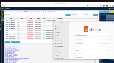

I can't seem to read the OTP bits on the stm32N6 with any of my boards with 2.22 of the stm32CubeProgrammer.
But i can on version
  • 2.21
Everything else works fine with the chip.
Brenden_PLUS
Senior
Well i guess my computer is the one out of spec i guess.  I'm going to be updating to ubuntu 26.04.  So i'll close this for now and if it continues then i'll repost this.

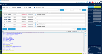

I can read OTPs just fine on my side with the DK board (Also it seems we have the same chip rev ID).
Can you share a higher verbosity log with both versions of the tool ? v2.21 vs v2.22 ?

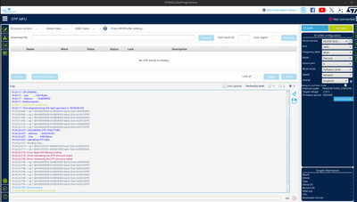

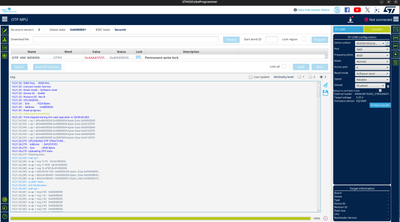

Didn't see that verbose thing!  Also I'm on linux, but it seemed to be a problem on windows as well.
  • Ubuntu 24.04.3 LTS
Logs are attached.
Version 2.22
Version 2.21
Did you figure out anything else, could you share any further details that might help us reproduce the issue?
