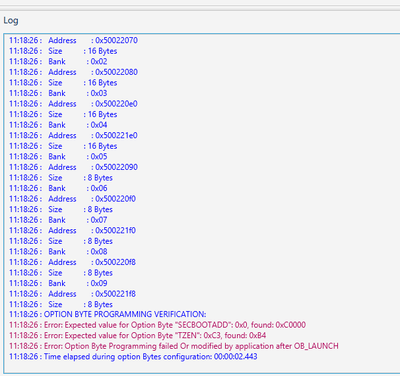

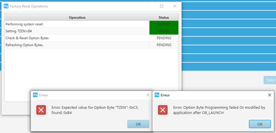

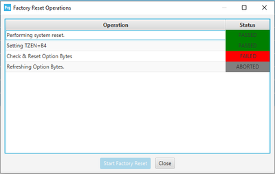

Hi I'm trying to reset the stm h563 to factory settings because I do some test before and I would like to use the stm for other things but I can't reset the changes I made with CubeProgrammer. I have those errors....

Hello @Gwen1,
The reset MCU to factory settings feature is currently available only for STM32U5. Support for the STM32H5 will be included in the upcoming release.
Thanks,
Amine.
