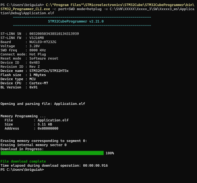

Hi @NArnd
I don't think this is a bug, I think it's just a path parsing issue.
To prove this, try running the following:
C:\"Program Files"\STMicroelectronics\STM32Cube\STM32CubeProgrammer\bin\STM32_Programmer_CLI.exe
You won't have any output because STM32_Programmer_CLI won't be properly parsed by Windows. It's a good practice to wrap the whole path containing spaces with quotes, the whole CLI becomes:
"C:\Program Files\STMicroelectronics\STM32Cube\STM32CubeProgrammer\bin\STM32_Programmer_CLI.exe" -c port=SWD mode=hotplug -w C:\SVN\XXXXX\Xxxxx_3\SW\Xxxxx3_ws\Application\Debug\Application.elf
 Let me know if this solves the issue,
Aziz

Hi Niclas,
Please include the C:\ in the quotes and get back to me. Or simply copy this to a CMD window and screenshot the result.
Thanks,
Aziz
FYI: To prove further that it's a parsing issue, you can test your original scripts (Without my suggested modification) in  PowerShell and not Windows CMD, the CLIs will run as expected.
PowerShell
Windows CMD
Looking forward to your reply !
Aziz
Hi Aziz,
You are correct. This is a parsing error. Weird that the erase command was parsed correctly but not the program commands.
These commands do almost what I need:
#Erase all
"C:\Program Files\STMicroelectronics\STM32Cube\STM32CubeProgrammer\bin\STM32_Programmer_CLI.exe" -c port=SWD -e all
#Program application binary
#Program bootloader binary
"C:\Program Files\STMicroelectronics\STM32Cube\STM32CubeProgrammer\bin\STM32_Programmer_CLI.exe" -c port=SWD mode=hotplug -w C:\SVN\XXXXX\Xxxxx_3\SW\Xxxxx3_ws\Bootloader\Debug\Bootloader.elf
